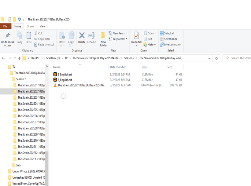

Why are Subs not showing up? I have the subs and the video files in the same folder

I have tried that recently with another show and I just re named these subs in that format and still not showing. I never had any issues in the past not naming properly, as long as in the same folder they would still show, just as “unknown”
You are also using an additional subfolder level for each episode. This is neither necessary nor supported in Plex. External subtitles won’t work under these circumstances.
Thank you both for the help, unfortunately I have applied proper naming and also removed the additional subfolder and still nothing. I now have all episodes and srt files properly named and in one folder and the subtitles are still not showing. I even did the plex dance after applying both suggestions and still nothing. So far the only thing that works is to manually upload them one by one on the pms webpage.

I got it working… so it seems the naming of the srt needs to be identical to to the video file plus the .en , then doing a refresh metadata has fixed it. all subs are now showing with the exception of ep13(which is not identical) after a refresh. Thanks for the help!!. in the past i could be lazy and not name properly and they would still show, just as unknown if in the same folder.
