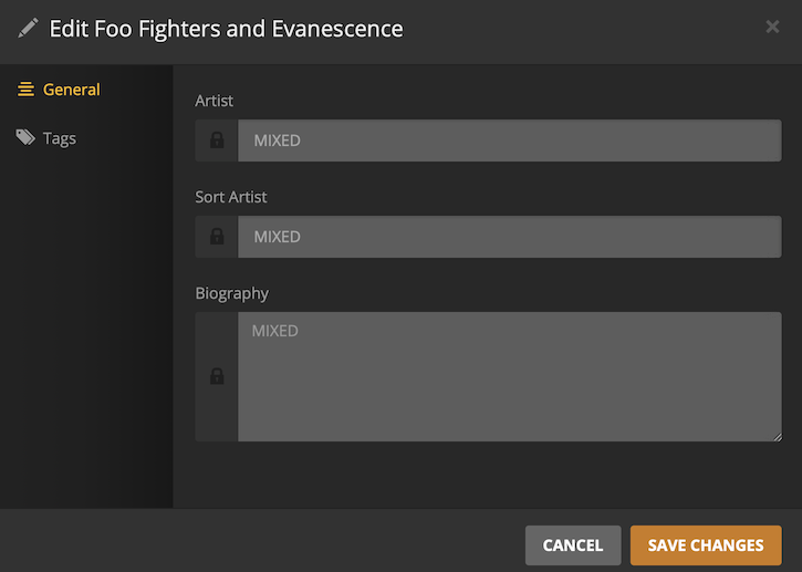

You can:
  1. select all artists (select the first, click Shift, select the last)
  2. click Edit
  3. clear Sort Artist (the field should show MIXED)
  4. click Save Changes
This field exists particularly to overwrite the Artist Name for sorting purposes… if you don’t want the artists to be sorted differently, you should consider not adding a tag for that.
Thanks. I tried that but it was greyed out
What is greyed out?
The dialog should look like this – just overwrite (or clear) the placeholder that says MIXED
Bildschirmfoto 2020-01-16 um 23.59.14
You can’t clear the ‘Mixed’ text. All you can do is overwrite it to something else.
I should say, if you clear the ‘MIXED’ text by typing a letter, then erasing it, it doesn’t change the tag when you save it.
@Explorer_200 I think your only recourse is to go back into Picard, or some other tag editor, and remove the artistsort tags that way.
You’re right.
However… you can overwrite MIXED with the same value for all the artists (e.g. Hello World). When you then re-edit the artists, you can clear the field (just tested with a test library on my server)
Yeah, that would work. Make sure you lock the field, though, or the next metadata refresh will put it back. And, with the ongoing issue of the lock not always preventing overwrites, I think the most reliable method is to clear the tag in the files themselves.
