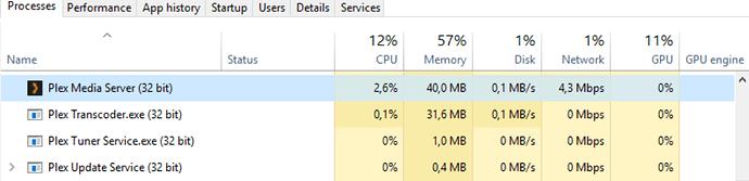

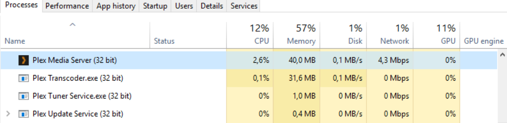

I have closed all applications this is the result
Nothing is loaded on 100%. Not in GPU, not in CPU.
Thermal throttling also is not the case, cause NUC small box is only slightly warm.
You closed all application including or excluding Plex? The first screenshot is showing ~70% for both CPU and GPU, the second is ~20%, a huge difference, maybe because you chose a different stream, you changed from ~12mbit/s to ~6mbit/s upload, the first time it was probably transcoding, but not the second time.

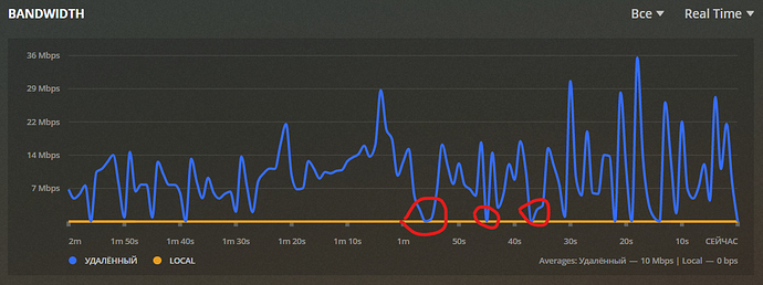

And why there are such falls in speed? After plot flies up stream immediately continues.
