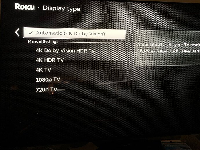

720p is usually a function of:
  1. The TV itself
  2. Any additional restrictions on the playback.
(Roku’s have a 720p mode – Better check that – switch to 1080p or 2160p )

Meaning in the Roku settings and not in the Plex settings?
Also completely subjective, but I asked the user if it looked like 4k and they said yes.
Yes.
The Roku itself defaults to 720p display mode.
When you set it up, you have to set it for the resolution of the TV

@eygraber
This is a Roku 4800X (DoVi support).
Had I not used proper cabling, it would have dropped to 720p.
