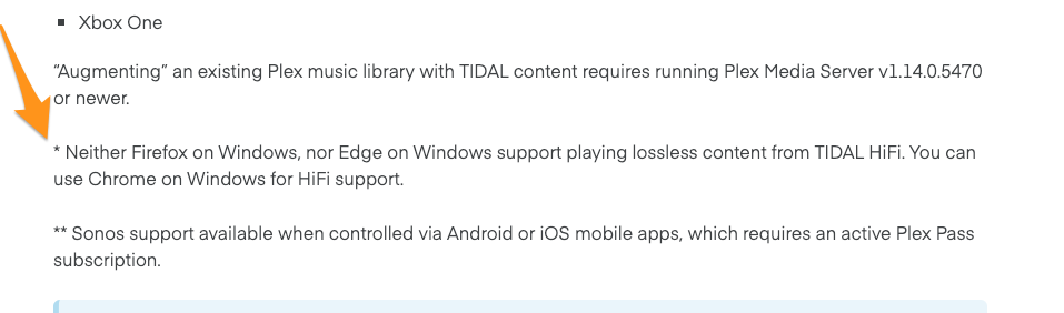

Edge is not supported for lossless audio from Tidal but I am not clear on which type you are playing. You definitely need DRM enabled in browser. This is the first time I have heard of hardware acceleration mattering for audio though.
Tidal can play no problem in Edge. Try this link One More Drink She Said / Web Player – TIDAL. The quality is max-flac - no problem. However, when I play any Tidal tracks from Plex when logged into my account - it will only work on Edge if I turn off hardware acceleration. If I play from Plex using Chrome, I have no problem. There is some interaction between Plex, Tidal, Edge and Harware acceleration that is not working.
What Tidals app can do and what ours can do are two separate things.
From our support doc on Tidal
