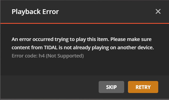

I get this error when trying to play from Local Plex Web.
Server is 1.18.5.2309
Web version is 4.12.3
and no Tidal is not playing on any other device.
I just tried playing the same song through Plex web (via Plex), it works. The online web version is 4.22.1. (on another point why is Plex web so far behind??0

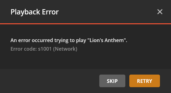

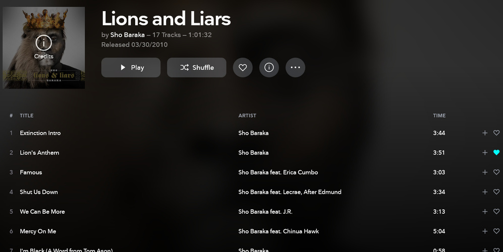

More to add. In a healthy dose of irony (look at the track name) I’m now also getting this error on some albums on Tidal.
This was trying to be played through the online web interface, not the local web interface.

I solved this one for my situation, hope the following notes help.
I noticed that my web version of plex would stream Tidal content when I was at work using Chrome or Edge, but still didn’t work from my home computer (on which the Plex server is running).
I found a Plex support article, and I checked my Chrome “content” settings because of this quote:
Note : If you disable DRM support in your browser, you may receive a security warning and/or be unable to play TIDAL content.
Still no luck. Then Then I found this forum thread, which gave me the final clue.
“Your connection to app.plex.tv has to be in https to be able to stream tidal content.”
Final solution:
I had my home Plex web browser pointed to 127.x.x.x:xxxxx/web/index.html, which looked normal, but could not play Tidal content. After I changed the web address to https://app.plex.tv/desktop, Tidal content now works!

But I’ve seen your problem before, too. In my experience, this Playback Error message is received when Plex can see a specific album in Tidal, but that album does not actually exist on Tidal.com. This explains how sometimes Plex can play Tidal content, and sometimes it can’t. When Plex can’t play Tidal content, go to Tidal.com & double check the album exists there.

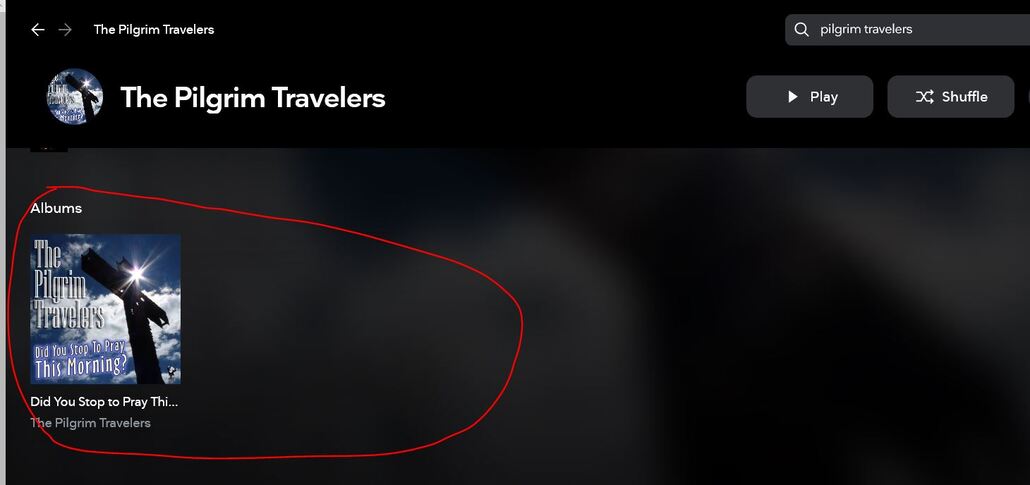

It happened to me on this album yesterday. When I search for this artist/album on Plex, it shows up, but when I search for it on Tidal.com, it’s missing.
Just a theory, but I think this also happens when content is removed from Tidal, it can still show up on Plex, but is unplayable.
This theory does have some validity, although it can be quite random in how it shows up.
For example the album I’m trying to play through Plex (added to Music) shows up in the Plex search of Tidal, but looking at Tidal direct, that album does not show up for me. So your theory is proved correct there.

I think this thread is touching on two issues here:
  1. The bundled versions of the Plex Web player that come with PMS don’t support DRM playback so TIDAL will fail here, please use the hosted app at https://app.plex.tv/desktop
  2. The discrepencies of available items between the official TIDAL app and Plex is something we’re working to minimize. If you see this or a specific item just doesn’t play please report this in the forum so we can take a look.

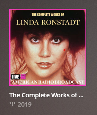

These two albums are listed as being on Tidal in Plex, but will not play:-
This album was added to Plex Music from Tidal but will not Play: -
I will add more in this thread as I find them

Adding another album, currently present on Tidal.com, and will pull into my Plex library, and will play on Tidal.com, but will not play through any of my Plex apps:
