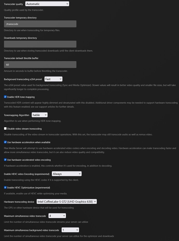

  1. Where is the transcoder temp set ? Default location?
  2. What does df -h show ? (where the container directories are mapped)
Hello! Transcoder temp is default (/transcode), but I manually mapped it to a folder on my cache SSD. >800gb free and files/folders do appear there when the transcoder is running so I know Plex has read/write access. Below is my df -h from within the Plex container. As far as I can tell nothing seems to be filling up.

Also, is there a quota limit ? (Your default transcode buffer length is set to 120 minutes – aka the whole file – which is unnecessary and wastes space )
I’m not sure what about the episode is making the transcode fail. A couple of days ago I had the same issues with a season of South Park, so tried removing the episode named by the hung transcode process (didn’t help, just errored on the next episode). After that I tried removing the whole season (didn’t help, just errored on a different show). The especially confusing part is none of these files are new– I haven’t made any changes to either of those shows in months.
I took out Lost S02E22, and this time it errored on Lost S01E01, which seems like it should have been checked before Lost S02E22 previously if it is stepping through the directories sequentially. See around line 44,000 for the similar log lines as you posted above.
Plex Media Server.1(1).zip (673.7 KB)
As for audio detection, I have /tmp manually mapped to a separate folder on the same cache drive as my /transcode folder. As part of my troubleshooting I just made a Plex folder on the cache NVME and then have plex/transcode and plex/tmp to keep all the permissions/space available consistent.
I’m not sure what you mean by quota limit– I looked through all of the server settings and couldn’t find anything about a quota, even in preferences.xml. I haven’t ever messed with the transcode buffer length, and the transcoder throttle is set to the default of 60. This is what I see as the options on my transcode page:
