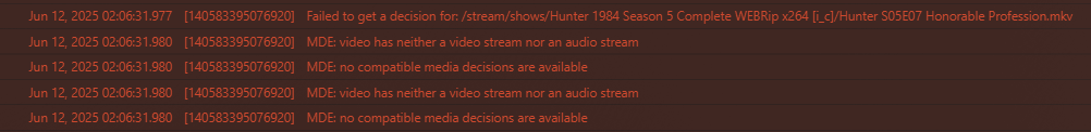

I get this error for almost every episode of the show I have:
EDIT: Upon further investigation, the error is related to a bad rclone mapped show. It still exists in my “Stream TV” library, but not in the rclone location. I deleted it from my “Stream TV” library. I will clear the logs, then watch them over the next overnight to see what happens and if the logs are clearer.
EDIT 2: I’ve attached the relevant plex media server log file.
Plex Media Server.30 log.zip (229.3 KB)
It would make sense to get the “no space” errors, as Plex and/or really any process would have no write permissions to the rclone mapped directory at all. I’m pretty sure I found my issue. 24 hours will tell.
