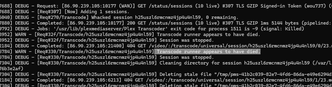

Hardware transcoding works fine when starting a movie. However, when changing the quality of the encoding (lowering or increasing the bitrate and/or resolution), it buffers endlessly and nvidia-smi no longer reports any instances of Plex Transcoder.
The logs simply report ffmpeg exiting with an exit code of -9, and stating “Transcode runner appears to have died.”
