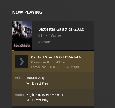

I seem to be having an issue where plex is transcoding VC1 encoded .Mkv to a LG G1 when it doesn’t need to
If I change the plex audio setting to enable DTS it then direct plays both the video and the audio stream, albeit with no sound because the tv does not support DTS. However the image is fine
If the tv is perfectly capable of playing VC1, why does it transcode to H264 when I turn off the DTS option?
Is there a way to stop the transcode?

If you start to transcode the audio track, Plex needs to transcode the video as well in order to maintain audio/video synchronicity.
Ahhh I was not aware that was the case
Thanks for the info! :smiley:
