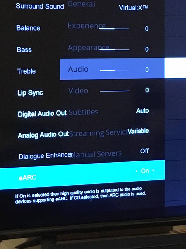

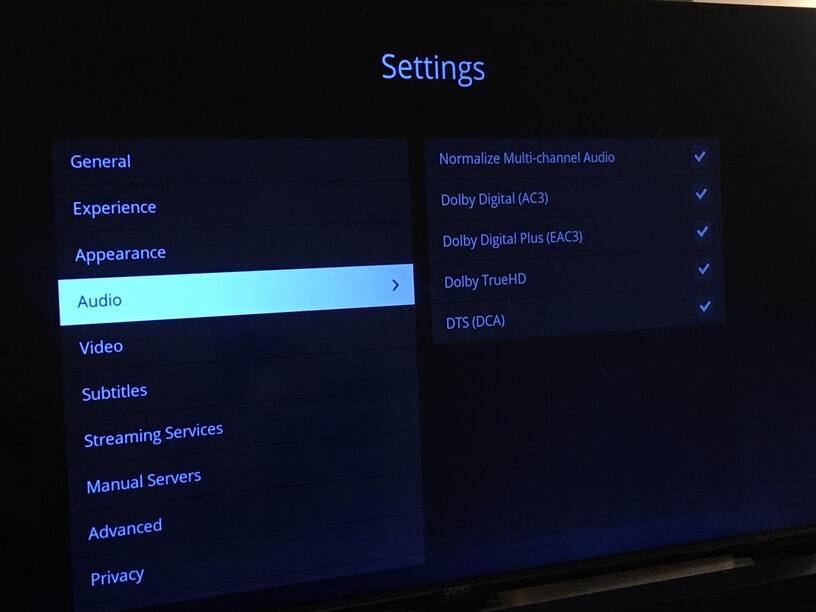

Guys, Plex app on my Vizio TV (V505-J09) will not play Dolby TrueHD and DTS-HD MA anymore, everything was fine until my tv was forced to install a new firmware update( I have also installed a new firmware update on my soundbar m51ax-j6). I have turned on the eARC function on my TV and I have made sure everything is connected properly but it seems that it just won’t play TrueHD and DTS-HD MA, whenever I try to play the videos, plex just automatically plays a crappier audio such as AC3 5.1 but on my laptop dashboard just says that it’s direct playing DTS HD MA which is incorrect. I already called the vizio tv support and the guy just kept saying it’s not the TV’s fault.
What are the audio settings in the app set to. Does the TV have it’s own audio setttings?
I’ve connected the soundbar via eARC. Everything was normal before the firmware update tho.
What is that “Virtual X” setting? Probably need to see your app logs. Logging for Smart TV App | Plex Support
Also, what are the choices for Digital Audio Out?
That is just my soundbar setting which is supposed to give you virtual overheard sound.
Choices for Digital Audio Out are Auto, PCM and Digital. The weird thing is that I can play some DTS-HD MA 7.1 videos but I can’t play most Dolby TrueHD 7.1 videos which is kind of infuriating.
