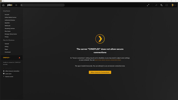

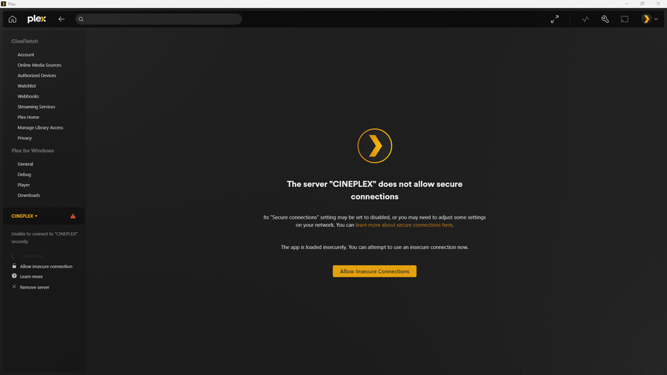

Any update available after 1.41.6.9685 has not worked on my NAS. It will say successfully installed after installing, but plex shows it cannot find my server and just keeps trying to reconnect, and ive let it sit overnight, and have done reboots, the only thing that works is to revert back to update 1.41.6.9685. I do believe my NAS had a firware update sometime in apr/may, but not sure if that would affect plex updates? But, yeah I even tried going back a couple more versions to go to the latest with no success. So currently stuck with version 1.41.6.9685

yeah, after i update the new version, the web address access also says the same thing. Ill add screen shot of it tomorrow.

both app and web screenshot after update.
