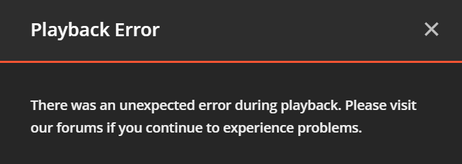

Plex Version 1.18.1.1966 keeps crashing
Not sure what is going on, but since I updated to this version today my server keeps crashing and I restart. Then it works fine for a few minutes then stops again. Definitely something is messed up in this new version. I have had a near-perfect experience up until the update.

I just installed 1.18.1.1973 and when I try to reproduce ANYTHING it just crashes the playback
I am having the exact same issue and disabling Hardware Acceleration from Settings > Transcoder fixed the problem too. It is now at least functional. Before it would crash immediately every time anyone locally or remotely tried to play anything. Thank you!! Hopefully they actually fix the introduced bug here soon.
