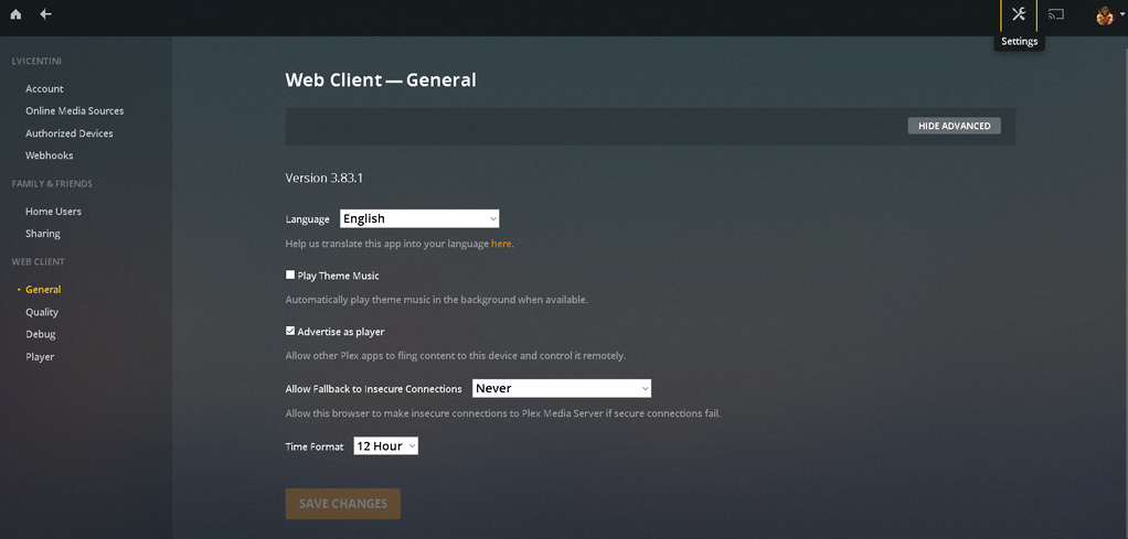

After reinstalling the CentOS 7.6.1810 operating system and Plex Media Server, this page only appears.
The option to remove the old device (Settings - Devices- Server), does not appear in my settings.
In the (Authorized Devices) option only my connection to the browser appears.
