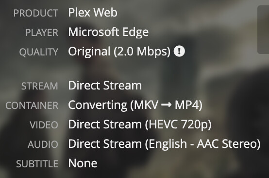

If I have a single 2Mbps MKV with the following specs (see below), then Plex will Direct Stream the Audio/Video and Convert from MKV to MP4 with the default 2Mbps Quality Profile (See Image01 below).

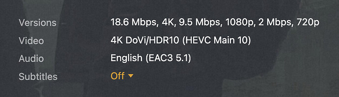

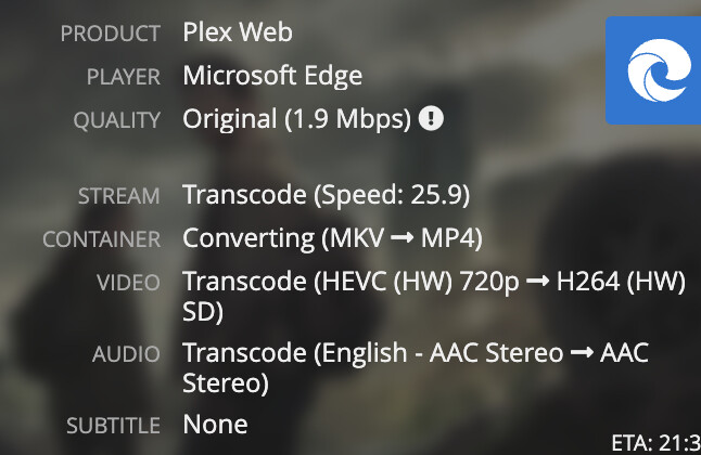

If I have the same 2Mbps MKV and an additional version (typically higher quality), then Plex will select the same 2Mbps MKV (because of the same 2Mbps Quality Profile) but Transcode the Audio/Video instead of Direct Stream (See Image02 below).
It will do this any time there is a version that exceeds the current Quality Profile. So if I have a 12Mbps file, an 8Mbps MKV that can Direct Stream on its own, and an 8Mbps Streaming Limit set, then it will Transcode the 8Mbps file. If the 12Mbps file is removed then it will Direct Stream again.
My expectation would be that if Plex can Direct Stream a file when there is one version, that it should also be able to Direct Stream when there are multiple versions.

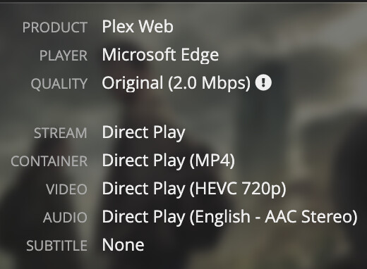

Here’s an example of what I see when there’s just a single version in Plex:
Here’s an example of what I see when there are multiple versions in Plex:
