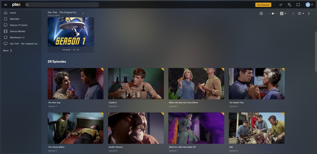

I’m trying to add “ST:TOS” to my “Various TV Series” library but it won’t show up (and yes; I have followed the naming guidelines).
I will be using the short form name for Star Trek series from here when referring to them; their folders have the full name.

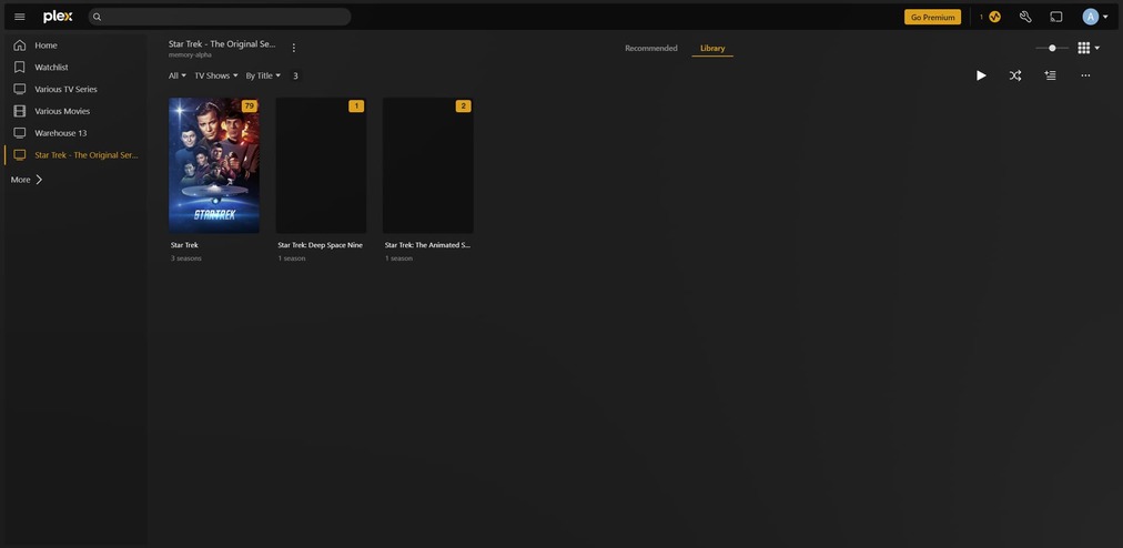

All I see is one entry for “ST:DS9” and one for “ST:TAS”; when I add “ST:TOS” as it’s own library it shows up but mistakes some local extra material for “DS9” and “TAS” episodes (which I assume is due to the issues mentioned here).
Is this due to some matching bug?

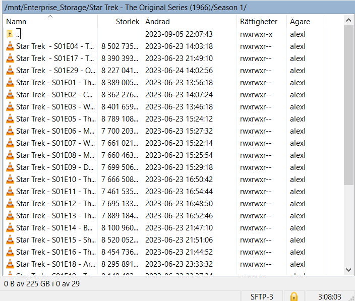

Can show us an example of your naming then? Do you have all the various star trek shows in one star trek folder instead of separated in the TV folder?
How the files looks via WinSCP (my server OS is headless Debian 12 Bookworm):

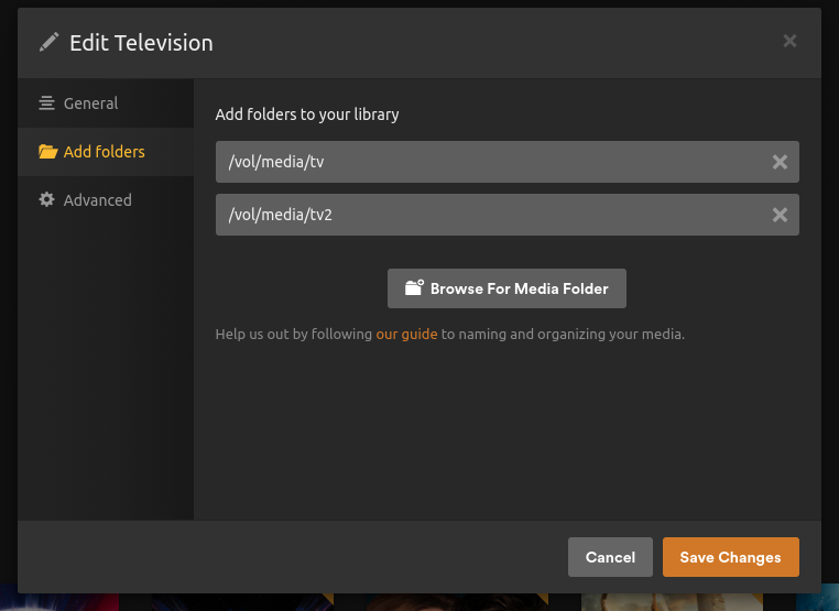

And how I include different shows on different drives on the server for the “Various TV Series” library:
That looks matched, I don’t understand the problem.
Never add individual show folders here. Should only be the top level fodlers like
Mount/Joe/TVShows
not
Mount/Joe/TVShows/Eureka
I’m showing you how it looks when I don’t have “ST:TOS” under “Various TV Series”.
I think I’ve figured out why it shows “TAS” and “DS9”; those episodes are included as specials for the Blu-Ray release I have.
To add to BigWheel,
you’re listing individual shows in the TV Series library ?
You should only list the parent folder which contains the series.
Like this:
Then your show folders and structure are placed underneath that.
