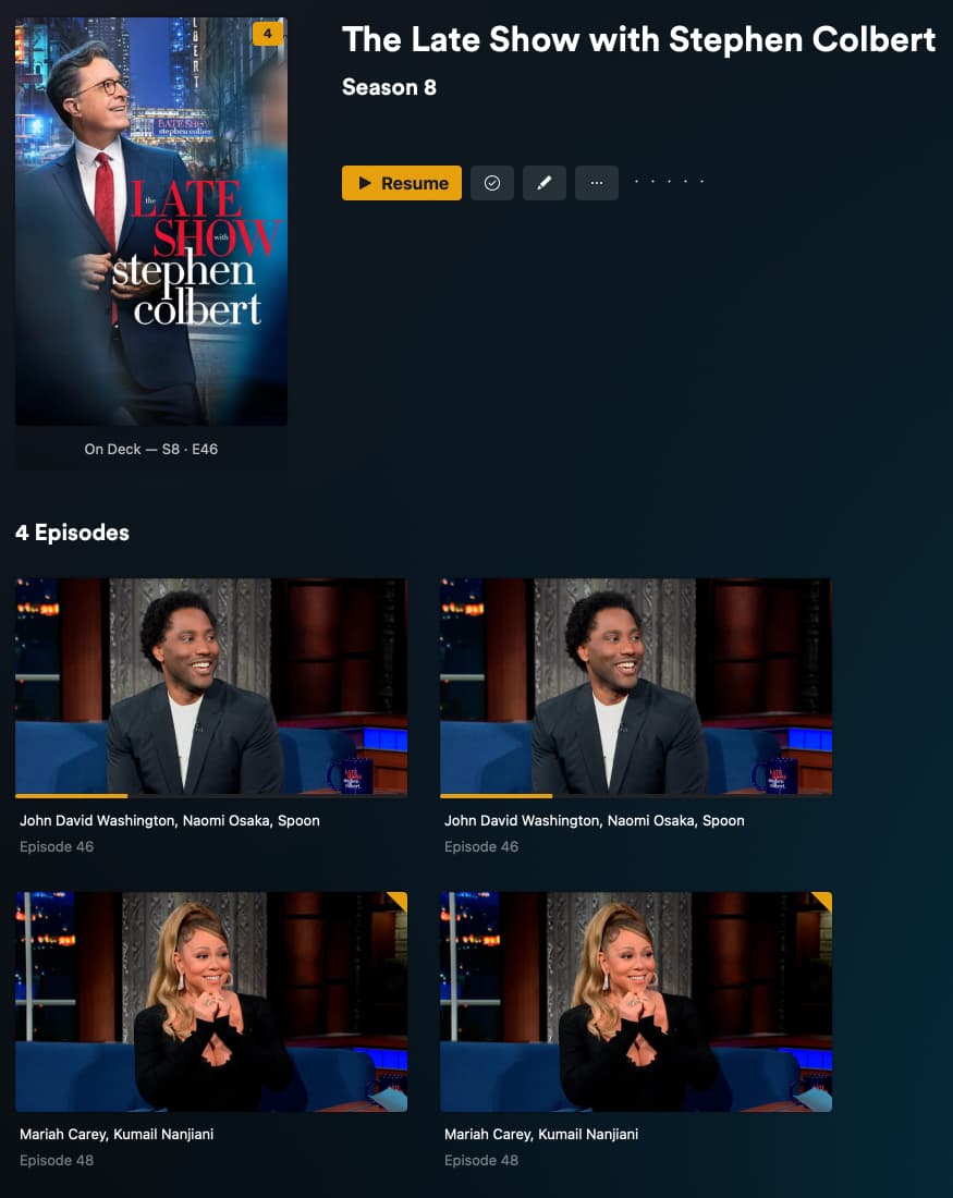

However, in Plex (any client, any version), they get wrongly matched like:
Additionally:
  1. If you “Get Info” on any of those 4 episodes, they are correctly matched to the episode files with their two versions each, just not the metadata about them, which is just the first two episodes repeated.
  2. Only the “real” first episode is partly watched (2022.12.05); the second episode shown here partly played is actually unwatched.

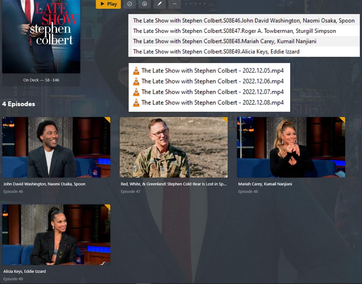

I have two copies of this show. One in English and one in German with Subtitles in completely different libraries.
Screenshot (927)
If the show is matched with an agent, it carries the same xml info so Plex regards it as the same episode no matter what you do
I guess you could unmatch one of the episodes but I suspect that’s not the solution you’re looking for
@JaysPlex That’s a different issue and seems to be working correctly, although maybe not to your personal preference.
My issue isn’t that it’s showing two versions of the same episode; it’s showing the same episode for two different episodes.
In my screenshot where you visually see 2 episodes duplicated as 4, that’s actually 4 unique episodes getting shown as 2-but-duplicated.

Just tested with 2 episodes named the same as you have, and they matched properly for me.
Have you checked the metadata for your files to see if maybe they have the same title.
Same here
It must have something to do with the way the files are duplicated and named unless you’re using an old agent I suppose
I tried both naming by date and s08e46 method and both work, pulling the right show titles and descriptions for all the episodes listed in your screen shot
@JaysPlex It looks like you have the 4 episodes, but not the two versions of each (8 files total). This is only a problem with multiple versions.

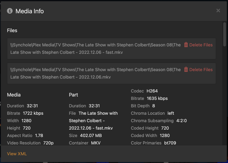

As you can see, the Video metadata, the Guids, and the Roles all indicate these are the “same” episode, but if you look at the Media > Part’s file attributes, you’ll see the files are the correctly dated ones.
Additionally for anyone trying to debug this, maybe the problem is that the parts are different lengths? The originals are approximately 40 minutes while the - fast versions are approximately 32 minutes. If you’d like to fully reproduce, name the files in date-based Plex format like The Late Show with Stephen Colbert - 2022.12.06.mkv and then run:
