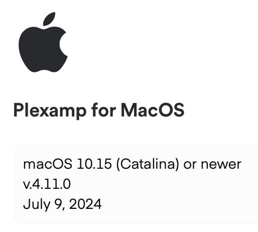

Plexamp download page still promises the application runs on Catalina and above, which they know to be untrue. This reflects poorly on the Plex team and their product suite.
