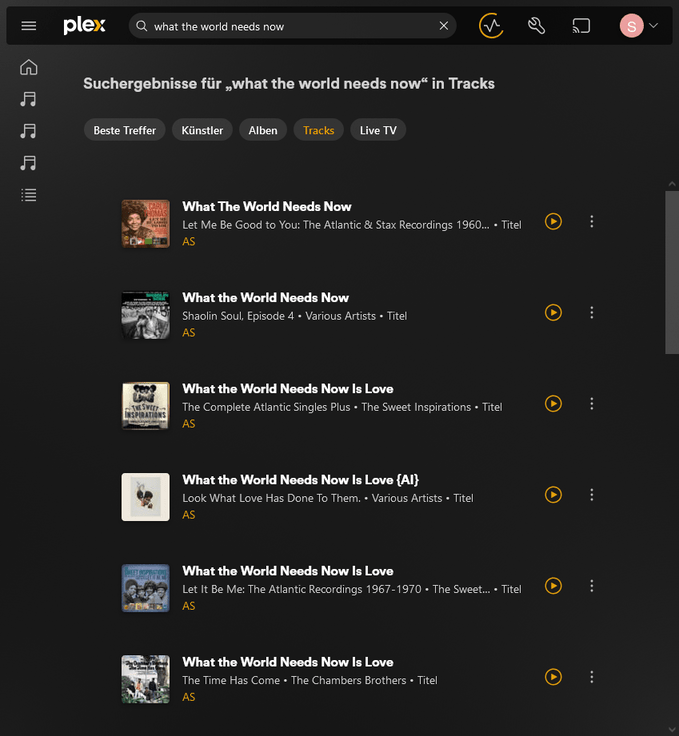

In the libraries on my Plex server there are no less than 19 versions of the track “What the world needs now” (… is love sweet love, that’s the only thing that there’s just to little of …).
Searching for “What the world needs now” on PlexAmp yields just three tracks (search on all libraries is enabled). Please note that there is no “>” indicating that the list of tracks is longer. Three tracks is all there is shown, so 16 tracks are missing:
… whereas a search via PlexWeb yields the correct list of tracks:

Funny that using “world needs” as the query in PlexAmp to find versions of the song “What The World Needs Now” brings up a complete list of tracks while using “world needs now” or “needs now” brings up only two out of the 19 tracks …
Hmmm. Confused.
