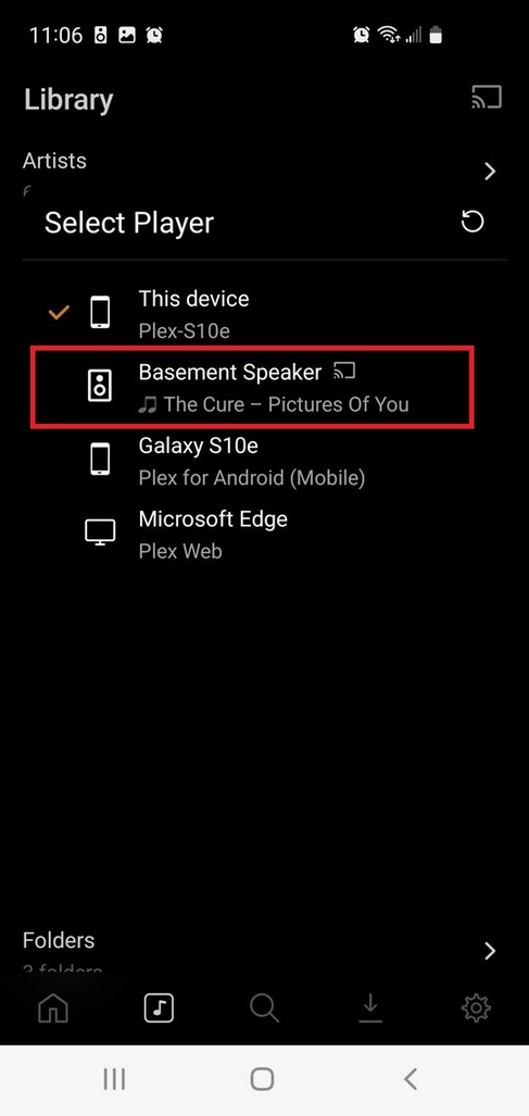

Here’s how it typically works for me:
  1. I’ll open Plexamp and start streaming to my Chromecast. I’ll select a playlist and select shuffle to start playback. Once I’m done listening, I’ll pause playback. Usually I’ll manually click “Disconnect” from the stream section and then close Plexamp. Lately I’ve been trying to perform all my steps consistently to reduce variables in troubleshooting this.
  2. When I want to continue playback, I’ll open Plexamp again. Testing again now after having stopped playback about 2 nights ago, here’s what Plexamp looks like when I open it.
  3. I click on the stream button at the top right and select my Chromecast.
  4. Now it shows the song still active, but paused. So I can either click the play button or just click that line to bring the song full screen.
  5. I press play and the song resumes.
So that’s how it works when it’s working. I’ve seen two different behaviors when it’s not working:
  1. When I re-open Plexamp, click stream, and select my Chromecast…it will not show the song that I left off at, and acts as if I’m just starting streaming for the first time. I have to restart the playlist and I lose my ability to resume from the same song in the playlist. This seems to happen somewhat frequently. I’ve experienced this behavior with both Plex and Plexamp.
  2. It shows the song that was paused, but I can’t resume. At this point I have to do some finagling like disonnect/reconnect stream multiple times or continue playback locally on my phone, then stream…and it restarts. Worst case but rarely it won’t resume and I have to kill everything. I’ve seen this behavior in both Plex and Plexamp on Android, but regular Plex was certainly much worse and pushed me over to Plexamp once I found it existed.
As a test, after following the steps outlined above and confirming it was resuming correctly, I restarted my phone, opened Plexamp, clicked stream, and the song was no longer playing…I have to restart playback of my playlist. So this to me indicates it’s something on the Android phone itself. In any case it’s certainly a clue.
