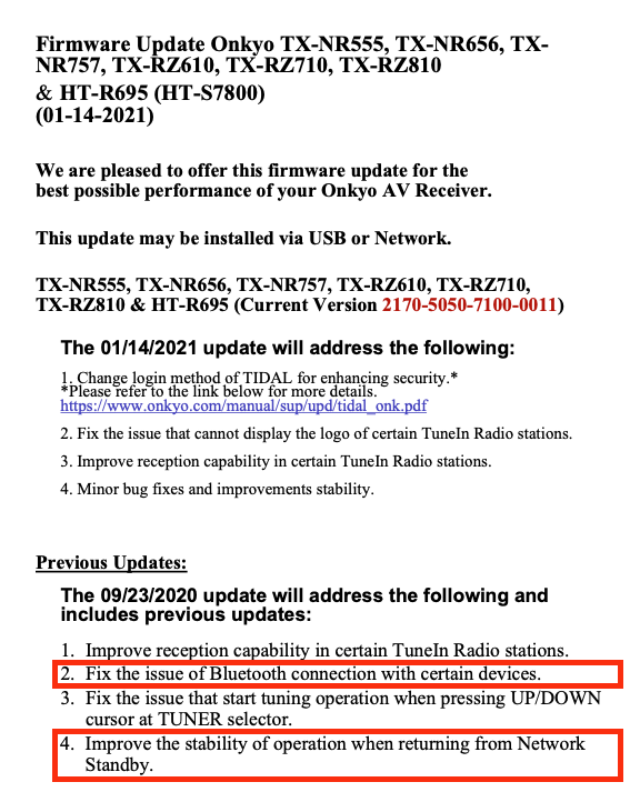

@DenzoNL I have a Onkyo TX-NR676. Be sure to check for any firmware updates for your model every few months. According to the most current update, Bluetooth issues #2 and #4 were resolved on the 09/23/2020 update. I can confirm that if you update to the January 2021 update, that Bluetooth issues should be resolved.
I’ll try this tomorrow, thanks!
EDIT: @DEA.86 unfortunately, that didn’t work. S

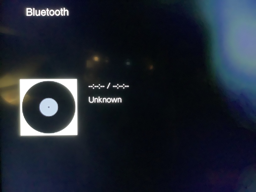

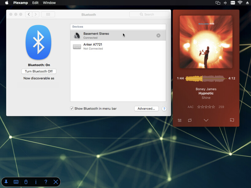

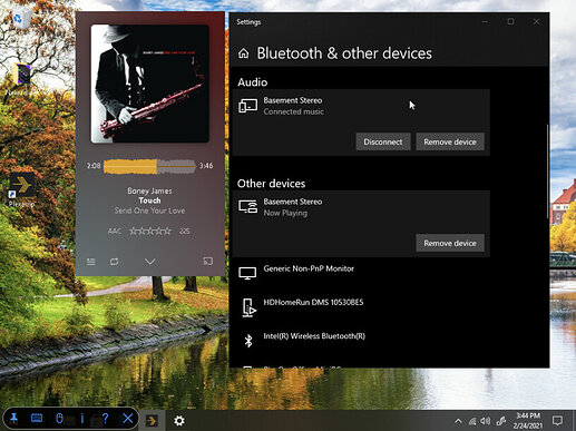

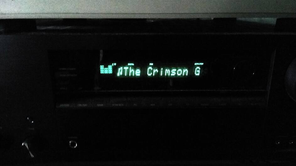

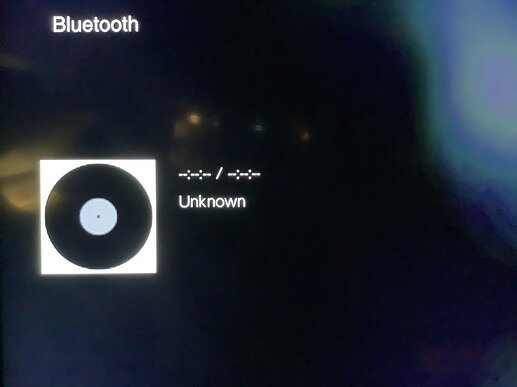

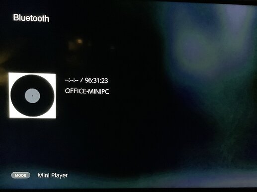

Bluetooth track data for Onkyo can be confirmed for PlexAmp Android but does not work for PlexAmp for Windows or PlexAmp for Mac. The artist, track, and album data do not appear.
Windows:
Pepperjobs Mini-PC with BT 4.2 - Win10 Pro - experimented with rollback of drivers and still had no pass through of data to the Onkyo receiver.
MacOS:

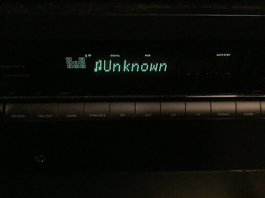

MacMini Late 2012 Catalina with BT 4.0 - audio passes through as UNKNOWN.
