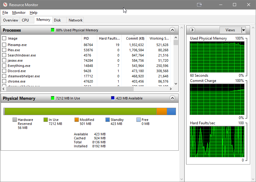

i did once but i will once the program setup from website finishes installing, i will use the same song and speed if it happens i will reply with and if i can take a ss if my PC does not have to be reset because of it
this is current version and also the song that did the last memory leek
still there on 3.8.2and i found might only happen on repeat mode
going to see if it happens in more than one song, edit again had to correct the version number does not help i have dislexia a bit and tend to sometimes type wrong words or numbers
tried another song, it seems i think the repeat song mode is one of the factors regardless of the song as i tested two songs and both provoked this if process lasso watchdog system would have not stepped in when it did(i set it to terminate plex amp to prevent me from having a complete freeze otherwise) i would had to reset my PC physically, anything else that is needed to troubleshoot this, idk where i can find the logs but it still happens,image
here is also a image after process lasso terminated the plex amp exe to avoid me that
