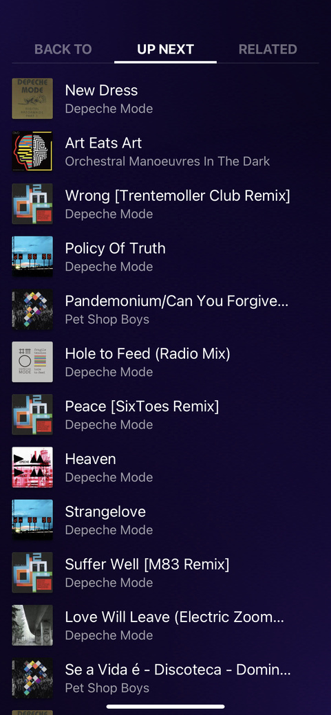

Images may tell more than my Frenglish. As you can see, Depeche Mode tracks are occupying the full space.
I think it is due to the number of selected artists as I could not recreate the issue with a handful artists, but I could recreate the issue with the same number of artists on two different IOS devices (different model, different OS version) running the latest Plexamp code:
Image 1 = Mix Builder - Artists selected
Image 2 = Play queue resulting from the “Play Mix” action
Kind regards
Not quite :sweat_smile: But they are probably occupying proportional space to the number of DM tracks you have vs other artists in there?

Keeping this topic open as 3.4.1 behaves the same: the Build Mix does not shuffle enough IMHO.
Selected the same set of artists, in the same order. Out of the 18 first tracks, DM appears 11 times, OMD appears 2 times, Pet Shop Boys appears 4 times and Peter Gabriel 1.

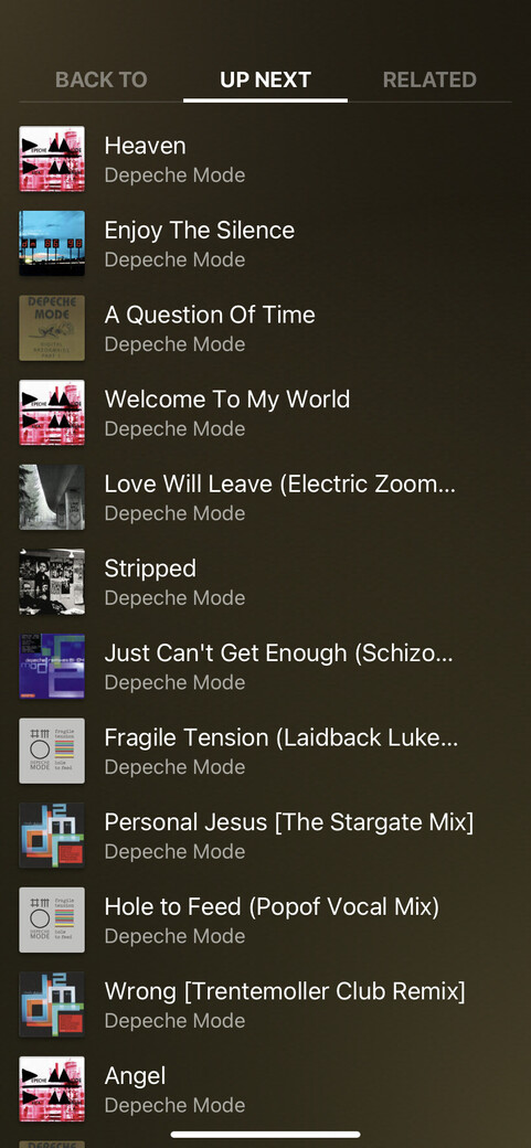

Shuffle is not really good for me, or my Plex server is seriously in love with DM.
I selected DM (26 albums) and The Rolling Stones (28 albums), then played the mix:
