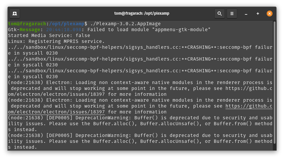

Also having the same issue on PopOS 20.04. Not a new install but has latest updates.
Version: Plexamp-3.1.1.AppImage
Permissions: -rwxrwxr-x
After removing the config Plexamp I get the following after running from terminal:
➜ ~ ./Plexamp-3.1.1.AppImage
Couldn’t install shortcut for Shift+CommandOrControl+Space.
Couldn’t install shortcut for Shift+Command+Control+Option+0.
Couldn’t install shortcut for Shift+Command+Control+Option+1.
Couldn’t install shortcut for Shift+Command+Control+Option+2.
Couldn’t install shortcut for Shift+Command+Control+Option+3.
Couldn’t install shortcut for Shift+Command+Control+Option+4.
Couldn’t install shortcut for Shift+Command+Control+Option+5.
Couldn’t install shortcut for Shift+CommandOrControl+Option+Right.
Couldn’t install shortcut for CommandOrControl+Option+Up.
Couldn’t install shortcut for CommandOrControl+Option+Down.
Couldn’t install shortcut for Shift+Alt+Space.
Couldn’t install shortcut for MediaPlayPause.
Couldn’t install shortcut for MediaPreviousTrack.
Couldn’t install shortcut for MediaNextTrack.
Started Media Service: false
Linux: Registering MPRIS service.
…/…/sandbox/linux/seccomp-bpf-helpers/sigsys_handlers.cc: CRASHING :seccomp-bpf failure in syscall 0230
(node:10332) Electron: Loading non context-aware native modules in the renderer process is deprecated and will stop working at some point in the future, please see https://github.com/electron/electron/issues/18397 for more information
