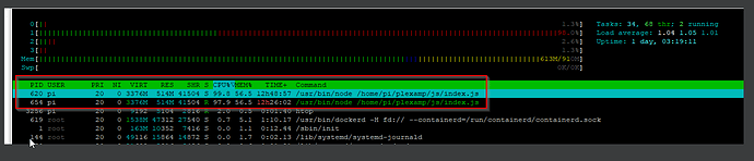

It’s working well, but CPU usage keeps on going up and up, over time even when I don’t use Plexamp:
There’s nothing else installed on the Pi, it’s only used for Plexamp. Is this normal behavior for nodejs?

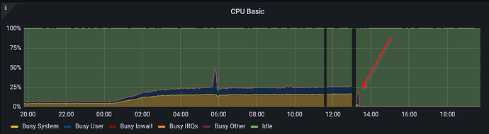

To visualize the issue more, this is the Pi:s CPU usage. At the red arrow is a manual reboot:

It looks like you have play queue caching set to 15 tracks ahead, that can cause CPU usage on lower powered devices and/or slow SD cards. You can also make sure you have a network speed limit set (advanced / caching / network speed).

I have set one track ahead queue (seems to be lowest possible) and 10Mbit network limit
I start a stream and see if the problem comes back.
Following the modifications the load looks more reasonable:
(this is metrics from the PI)
elan
October 2, 2022, 7:22pm
11
OK, glad to hear! For some reason on the Pi (esp slower + with slow SD) I/O is expensive.
Indeed, just 3 IOPS at 800ms - let’s say it’s quite slow …
