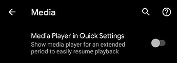

one more thing, try playing with the new Android setting around the notification: Settings > Sound & Vibration > Media and see if it makes a difference.
