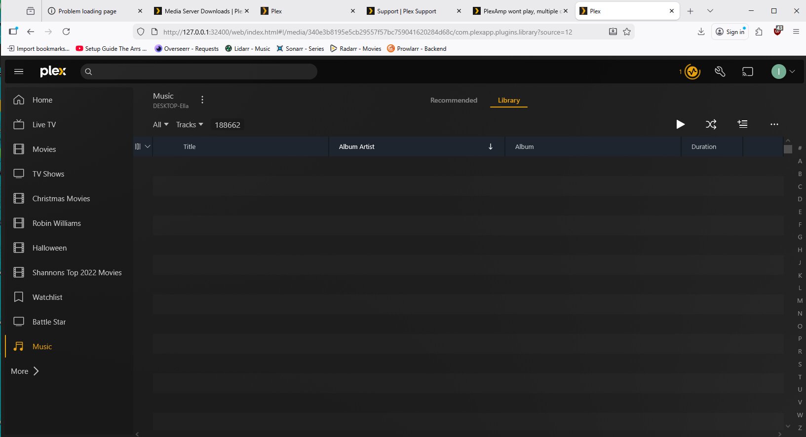

Edit: added pic of what I see in plex.
It doesn’t look like you’re seeing music in Plex web either?
You haven’t posted Plexamp logs but I would suspect there’s potentially some corrupt data in the database (invalid UTF-8, e.g.)

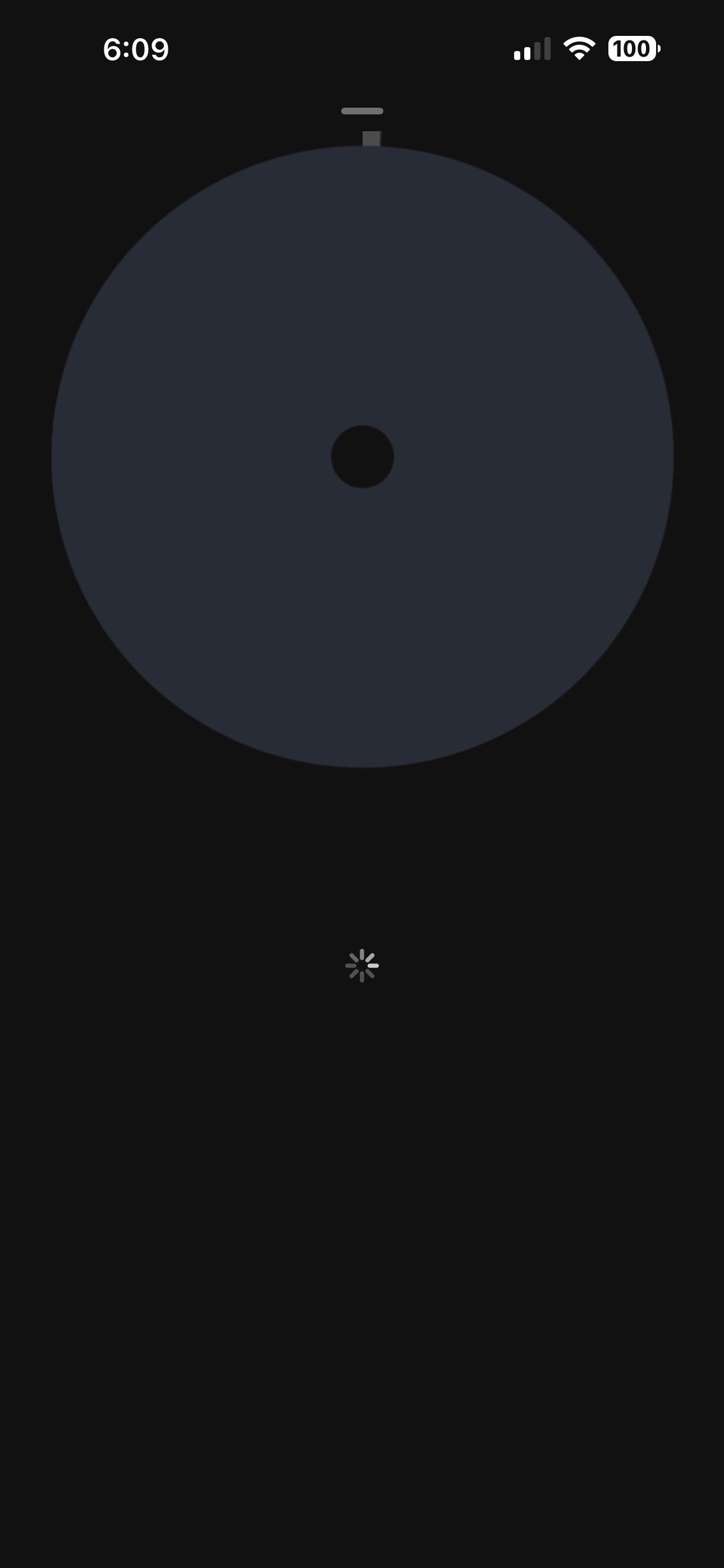

Thanks for the reply. I have attached logs. I reloaded music (again) in plex and in plexamp (iOS) I am getting a spinning wheel when going to play all music. Unsure where to turn now.
Edit: attach what I see in iOS (multiple devices)

To clarify, Plexamp works fine on desktop/wired, but fails on desktop/WiFi?
Just did some testing and strangely enough music works through the Plex app on windows PC with WiFi. It is only mobile devices having an issue playing. On mobile devices I get the above screen with a spinning circle.
What about Plexamp on Windows PC?
Yes, Plexamp on Window PC over LAN works.
