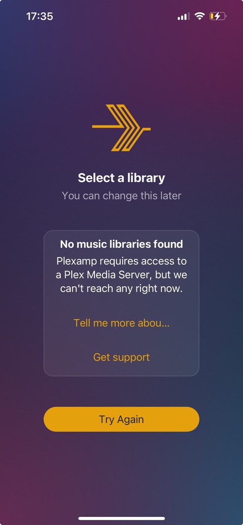

Open app > login using credentials > Go to Select a Library page where I have the spinner until I get the following:

I’m not a software engineer but the fact that both Plex and Plex Dash can find my server locally and remotely points to the app as the culprit.
Fixed. I feel like an idiot.
TL;DR You need to have a music library on your media server recognised by Plex, i.e. your music needs to be added to the main Plex libraries.
So I have my media library set up with movies and TV shows, but on my server I have a music folder. In my mind I thought Plexamp would create its own music library separate from the main Plex setup. Turns out you need a music library in Plex for Plexamp to work.
So for future reference, add your music to your main Plex server and then it can be found by Plexamp. Not sure if I’m just stupid or this needs to be explicitly stated somewhere.
