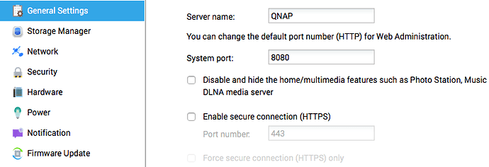

Port 80 works, but then I get an error launched on port 443

Not sure what is running on 443. I have don’t have the webserver on
If I change the Settings.cfg to:
enable_webserver_ssl = False
Then the server seems to run. But Trailers will not load. I see in the log that it is intercepting and redirecting DNS communications.

EDIT:
So I got that running by disabling SSL in General Settings

  4. In order to free port 443 - Disable “Enable secure connection (HTTPS)”
  5. In order to free port 80 - Enable Web Server on port 81 (I hope that using port 80 for PlexConnect does not prevents me using Let’s Encrypt certificates, I’ll think about that later, anyhow I can stop PlexConnect and renew the certificates manually, so this is not a problem)
