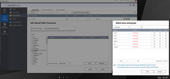

Hi.
I can see “PlexData” share in control panel -> Shared folders; it shows as having no Volume. I have never seen it before so I assume that was somehow created by 1.19.5?
Regardless, I cannot see it in FileManager in order to create the “Plex media Server” linkage.

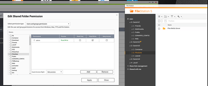

Interestingly, in permissions, it was showing Admin as two entries, one as Read-Only and one as Read/Write. I changed the Read-Only to also be Read/Write, hit “apply” and it disappeared, leaving only one entry with Read/Write.

I removed the PlexData share and created it myself. I then installed “PlexMediaServer-1.20.0.3125-9661fc77c-armv7hf_neon.qpkg” again. This time it came up with no error (other than the unsigned warning on install).

Plex Media Server folders now appearing in PlexData share
Brilliant! …that worked for me as well.
I cannot see Plex media Server from my Mac (the Alias does not work like it does for the “Plex” share created by PMSLibShare), but it works perfectly within QNAP File Station.

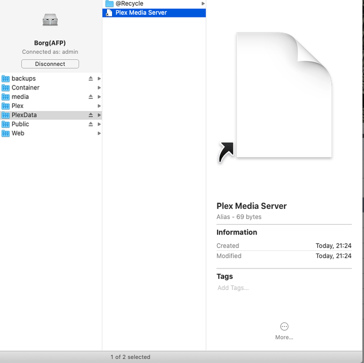

OK, for me, the latest version PlexMediaServer-1.20.0.3125-9661fc77c-x86_64.qpkg gives me the following:
  • PlexData is created with no permissions
  • Once I have given my self permissions, I can see (from my Mac) an alias to Plex media Server, but clicking on it does not work:
    Screenshot 2020-07-26 at 21.29.34
I should add that my connection from my Mac to my QNAP is over AFP (not SMB).
If you go into the share and set the AFP sharing permissions, does it now show up as you expect?
What I’ve done is back off all permissions completely. When the share is created, it is created with empty permissions. (as if you didn’t set anything in the GUI when creating it)
Also, IIRC, be careful of Apple’s AFP cache.
I am not aware (cannot find) and AFP specific sharing permissions. Where are they?
I set the “normal” permissions and can see inside the PlexData folder on my Mac:
…but it shows Plex Media Server as an Alias that does not work (as per the snapshot above).
that is consisten with NFS. NFSD (QNAP side) does not derefence prior to sending.
Now mount it with SMB (which is the Apple default now) and you’ll find it maps correctly
Here is where I show it before exporting NFS (fails), CIFS before and after adding permission

yup - works perfectly!
I did not realise that Mac used SMB as default.
