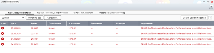

The latest Plex Server beta update causes the following error. The PlexData share already existed so I’m assuming it’s not checking to see if exists first.
Message: WARNING: Could not create PlexData share. Further assistance is available in our Support Forums. Continuing without.
