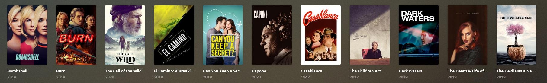

So Video nodes worked great and library is now sorted, however it seems that there’s also a problem when sorting a movie that starts with “The”
This is how it’s sorted in the Plex app (The Grudge for example)
But somehow, Kodi doesn’t seem to know what to do and ignore the Sorting title, in the case of the Grudge, it ends up being sorted in the G (Same applies for the other movies that starts with “The”)
Updating metadata / try rename it doesn’t seems to do anything, maybe it’s from the Plex side, it’s weird, other content I’ve renamed works, except the one that contains “The”
Interesting thing is, you can change the display title, it works, but the Sorting title that contains “the” is ignored for some odd reasons
Strange, when I look at Plex it is how you are seeing it in Kodi.
Edit: I just assumed Plex disregards titles starting with “The”
In Kodi, navigate to Settings, Media, General. Enable or disable “Ignore Articles when sorting”
