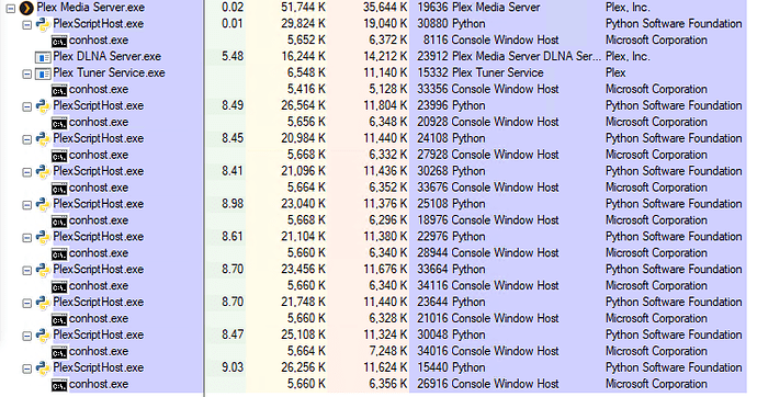

PlexScriptHost threads overview:
Plex DLNA Server overview:

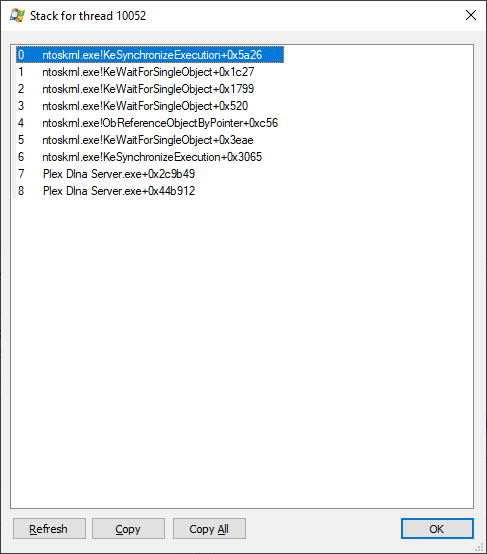

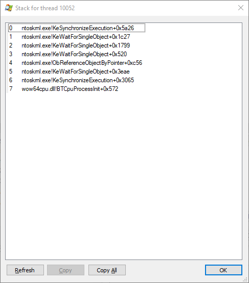

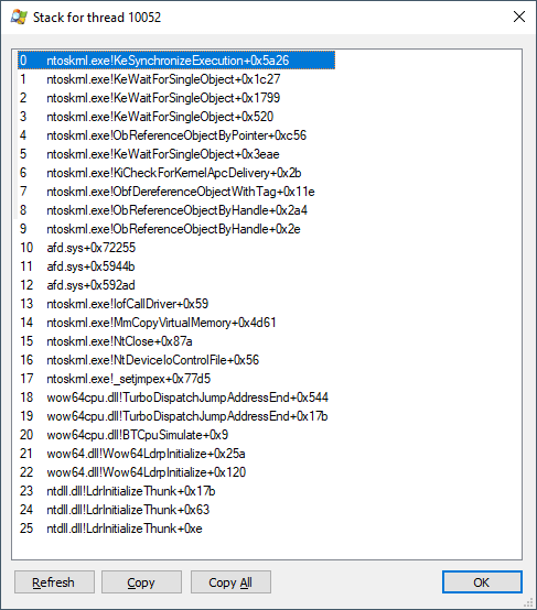

C:\WINDOWS\SysWOW64\ucrtbase.dll is the file that is taking the CPU ‘inside’ the Plex DLNA Server.exe process.
I now noticed you can also show the stack inside of the DLL thread. Multiple screenshots:
Hopefully these are helping the developers to fix the issue.
