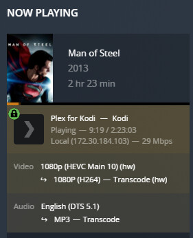

I have found a bug in the latest version.
I have a couple of HEVC files that have DTS audio.
P4K is transcoding audio where isn’t needed. It used to passthrough the audio since I have a spdif out on my RPi3.
Captura de tela 2021-09-26 231356
My client is running on RPi3 and my server is on the Nvidia Shield TV.
Can you have a look at that for me?
Please let me know.
Thanks!
