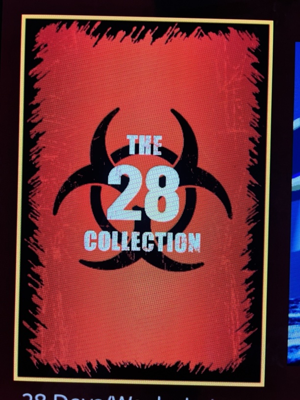

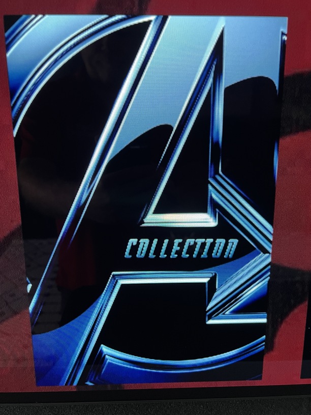

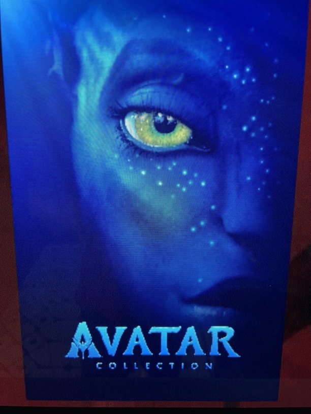

Weird. I’ve just tried this and the returned image is almost the same for movie posters and collections, but the endpoint we query is different. I can’t make out any quality differences on collection posters.
Have you tried deleting Textures13.db as well as the content of userdata/Thumbnails?
Edit: The returned images differ slightly in height; maybe that’s the source of the issue (and results in bad vertical scaling). I’ll need your confirmations that this still happens after clearing the above
I did delete that db file and the entire cache several times when I was trying to work out if it was an error on my part. Thanks for looking into it.
A vertical scaling issue would make sense. The results do look like that.
Likewise, I had deleted both of those several times as well. I just did again, and rebooted. No change. Note that some are better than others. It just looks like some are higher Rez files and the low Rez get really Janky.

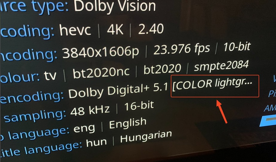

Hi, CPM build A13 (based on CE 21.2) is out, and I noticed that the in the PlayerProcessInfo screen at the Player / Audio encoding, there is [COLOR lightgr…] shown. In A12 version (based on CE 21.1.1) it shows properly with (I think in green color) the “ATMOS” text.
Would it be possible please to update Plextuary CPM skin to A13?
Thank you.
ps.
Attached a picture what I mean:
Don’t mean to be pedantic but it’s only a pre-release version of A13 which is out. It’s been released for testing and debugging.
Yeah, but I don’t think this skin related change will be different in a non-prerelease version. I am not even sure if the bug I reported is CPM specific issue or was introduced by CE 21.2 (which is not a prerelease).
In any case, it was more like a heads up that something is wrong, and there is no expectation that it will be fixed with priority.
