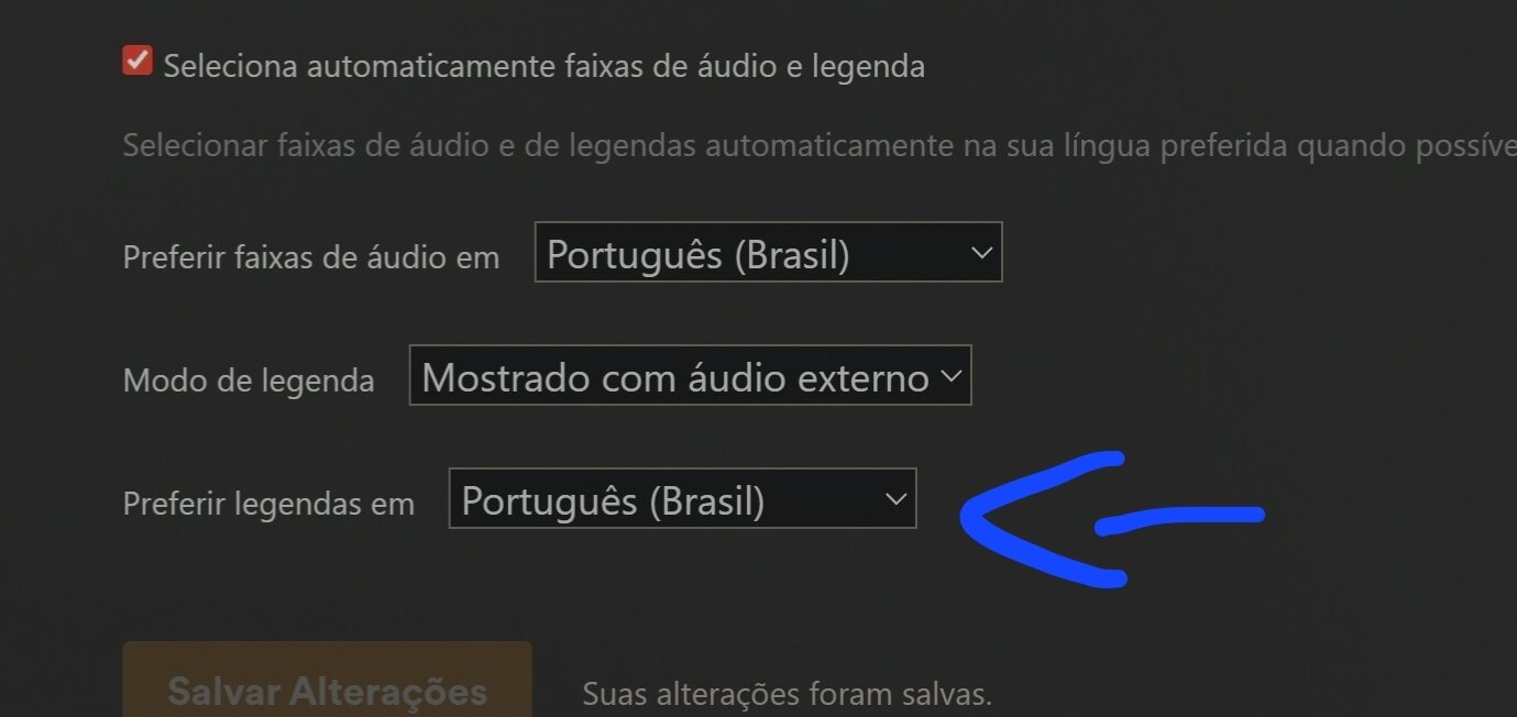

Good afternoon, @panni I discovered that if you leave this option set to Brazilian Portuguese, the subtitles we’re looking for in PM4K will be in Brazilian Portuguese. I only just found this out. Before, it was only set to Portuguese.
Oh yeah I think they fixed it recently
