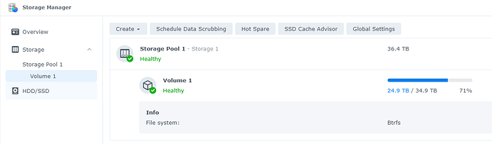

It’s BTRFS; I have a single storage pool with a single volume on it.
