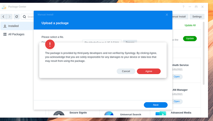

I had no issue migrating Plex Server and getting it up and running on DSM 7. One problem I’ve run into is that when updating to a new version of PMS, it seems to be completely random if the upgrade will actually run. This is definitely an DSM 7 issue as i didn’t have this problem before upgrading. My PMP notifies me a new version of PMS is available, i download it. I log into my Synology NAS and do a manual install. Doesn’t matter whether PMS is running or stopped. Once i click install, the screen swirls and just hangs OR logs me out of the NAS and when i log back in, there’s nothing running.
Here’s where it gets interesting. I can try this 15 times and at random, it will work once. I will get the red warning box about proceeding with the install like normal under DSM 7. I’m currently trying to upgrade to PlexMediaServer-1.25.1.5286-34f965be8-x86_64_DSM7 and i’ve yet to successfully get it to upgrade. Anyone have any ideas? Cheers!

Thank you. That’s clear DSM 7 is having problems processing the SPK file you uploaded.
It should, as you know, show you this
and then allow you to continue upgrade.
