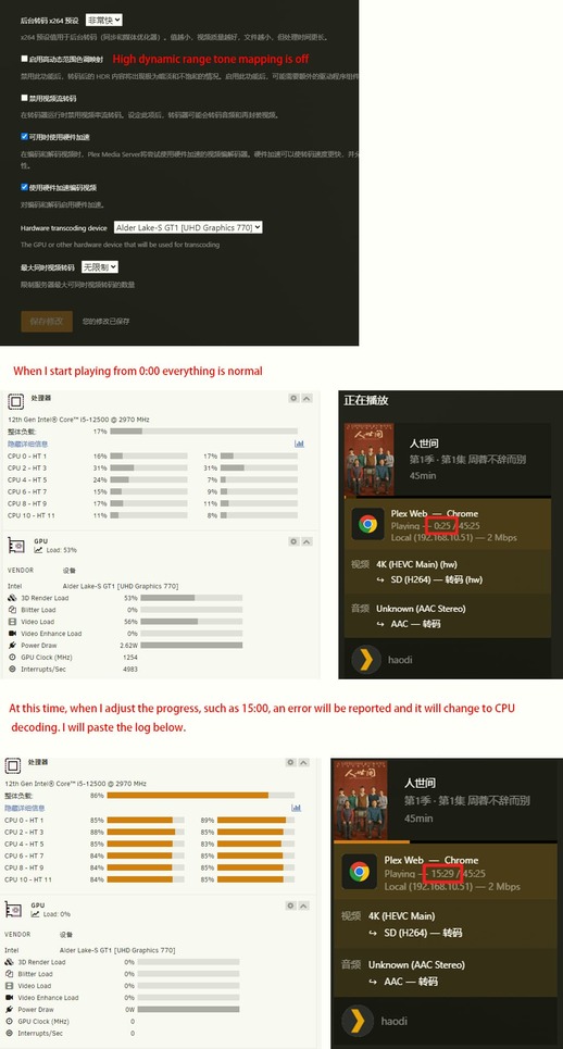

It is /dev/dri→/dev/dri. I click to start playing renderD128 and card0. Everything is normal. For example, if I fast forward to 20 minutes (the hardware decoding buffer only reaches 2 minutes), an error will be reported at this time, and it will be changed to CPU decoding, renderD128 and Card0 doesn’t work anymore. I don’t know if I say this, do you understand?
@haodi
I am starting to understand. Thank you for being patient with me.
Is this correct?
  1. You start playing with HW transcoding and tone mapping
  2. Playback is normal.
  3. The buffer fills to its default 2 minute level
  4. Now you seek ahead in the file ( 10 minutes ? )
  5. HW transcoding & tone mapping fail.
Is this correct ?
If this is correct, AND you turn HW tonemapping OFF.
Can you then freely seek around the file without faults (HW transcode normal) ?
I took a screenshot to express it to you, hoping you can understand my dilemma!
Sep 21, 2023 23:53:31.915 [22884886059832] 错误 — [Req#4ffd/Transcode/1mzps95qrrrmdvo1ty6aiqqt/16d764a7-e958-422b-b74f-df6803c2e14f] Impossible to convert between the formats supported by the filter ‘Parsed_hwupload_2’ and the filter ‘auto_scale_0’
Sep 21, 2023 23:53:31.916 [22884881718072] 错误 — [Req#503c/Transcode/1mzps95qrrrmdvo1ty6aiqqt/16d764a7-e958-422b-b74f-df6803c2e14f] Error reinitializing filters!
Sep 21, 2023 23:53:31.916 [22884886059832] 错误 — [Req#503e/Transcode/1mzps95qrrrmdvo1ty6aiqqt/16d764a7-e958-422b-b74f-df6803c2e14f] Failed to inject frame into filter network: Function not implemented
Sep 21, 2023 23:53:31.916 [22884881718072] 错误 — [Req#5042/Transcode/1mzps95qrrrmdvo1ty6aiqqt/16d764a7-e958-422b-b74f-df6803c2e14f] Error while processing the decoded data for stream #0:0
