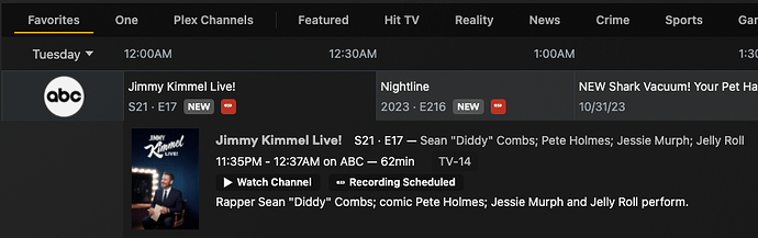

The JKL! 30 Oct 2023 S21E17 show Guide EPG data listing (ie, screenshot before airing):

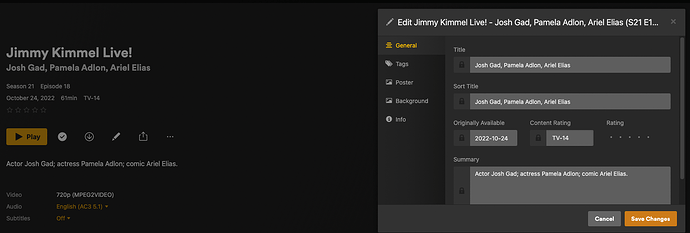

The recorded show corrupted EPG data (ie, after recording finished):

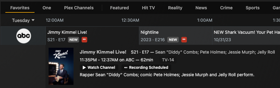

The JKL! 31 Oct 2023 S21E18 show Guide EPG data listing (ie, screenshot before airing):

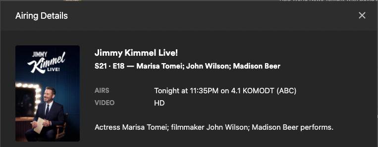

The JKL! 31 Oct 2023 S21E18 show DVR Schedule EPG airing details (ie, screenshot before airing):
The recorded show corrupted EPG data & the correct filename (ie, after recording finished):
