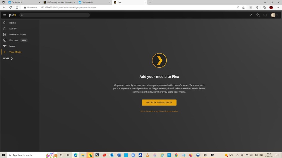

I have Asustor NAS, I have PMS App installed, it’s been working lovely for years, now all of a sudden, when I click the App, none of my media is there. When I try to add, it says ‘Add your media to Plex’ and a link to ‘Get Media Server’ but it’s already installed?

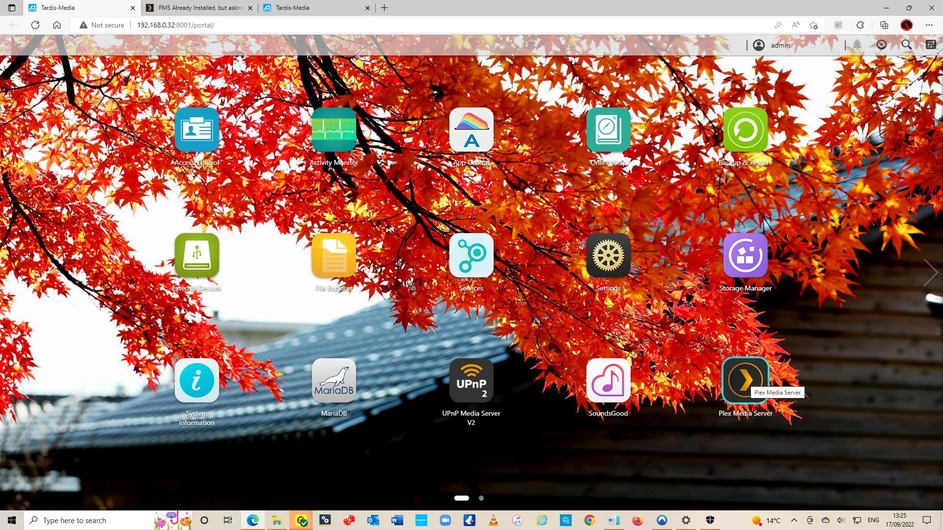

Thank you, yes I’ve opened through my NAS ip (I think), it still doesnt recognise my NAS as the server when I click on the App direct on the NAS:
I just get this:
The fact that you see this page means that Plex server is indeed running.
It’s just that you are unable to access it, due to a problem with the user authentication.
The cure for that is forcing the server out of its currently used Plex user account and re-claiming fresh – just like you did when you installed it the first time.
