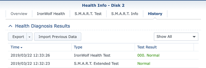

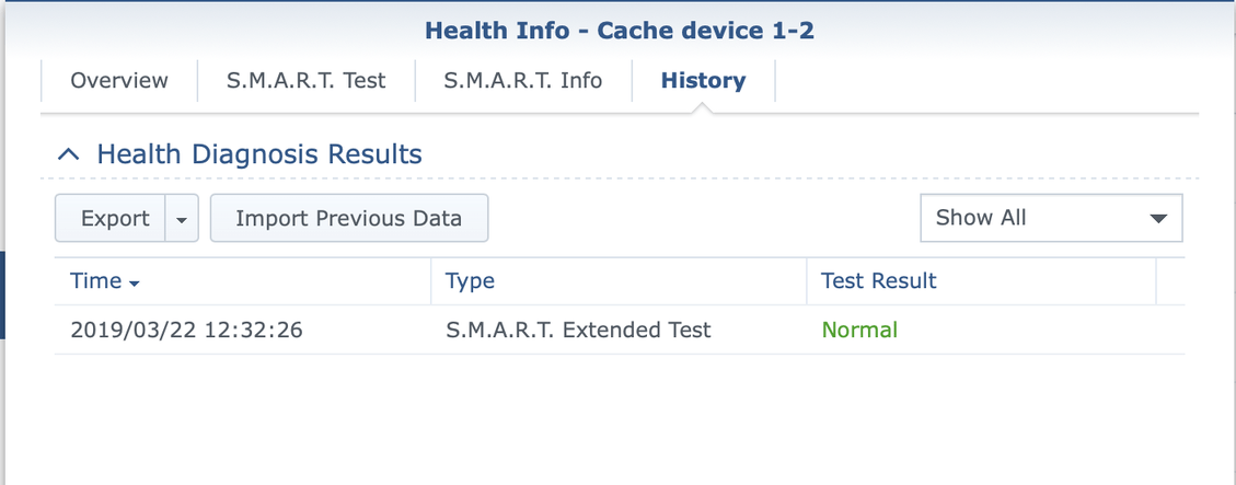

I’ve launched the extended test earlier today, I’m guessing this will take a while !
The extended test is done, and I got no errors.
