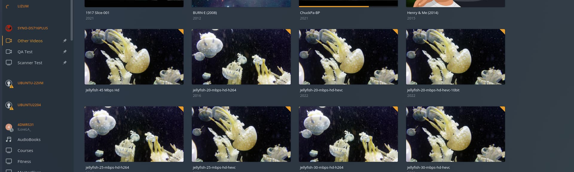

I just got to our DS716+
bash-4.4# docker container list
CONTAINER ID   IMAGE                         COMMAND   CREATED         STATUS                   PORTS     NAMES
e50833ef1adc   plexinc/pms-docker:plexpass   "/init"   4 minutes ago   Up 4 minutes (healthy)             Plex
bash-4.4# cat CreateDockerContainer
#!/bin/bash
docker run \
-d \
--name Plex \
--network=host \
-e TZ="EST" \
-e LANG="en_US.UTF-8" \
-e PUID=297536 \
-e PGID=297536 \
-e PLEX_UID=297536 \
-e PLEX_GID=297536 \
-h dockerplex \
-v /volume1/PlexMediaServer/AppData:"/config/Library/Application Support" \
-v /volume1/PlexMediaServer/AppData/tmp:/tmp \
-v /volume1/PlexMediaServer/AppData/tmp:/transcode \
-v /volume1:/volume1 \
-v /volume2:/volume2 \
--device=/dev/dri:/dev/dri \
bash-4.4#
It immediately picked up the overlay, without errorr
Yes the GUI complains but it does work.
They apparently don’t like spaces in the path name.
Have you tried putting quotes around it to appease the GUI ?
If it doesn’t work with quotes, I would definitely file a bug report with Synology because spaces in file names is , as you know, 100% legal.
