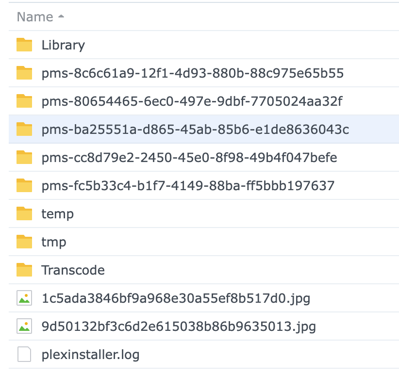

I’m not sure how to troubleshoot. Maybe I’ve mapped a volume wrong in my docker-compose and Plex can’t find the transcode folder? But, I don’t transcode and actually turned off remote sharing to try to fix this. Also, the issue happens sporadically.
As an update, I just checked my docker install folder and Plex has added many new folders for EasyAudioEncoder. Surely this is related. Screenshot attached.
These are the volumes I’ve mapped. Is this wrong? Plex does use the /config folder from the first volume mapping despite me not explicitly pointing to that in the install folder, but it does not use /tmp, which is empty. I had trouble finding a docker-compose that worked and maybe this doesn’t.

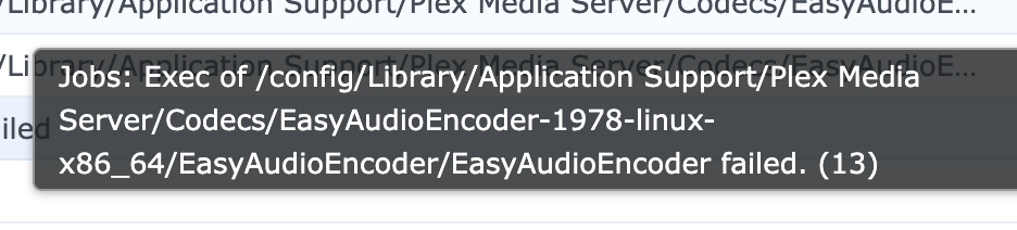

But, I’m having the same problem. The console is generating those transcode issues and this is in Container Manager:
Now I really am stumped, because I thought specifying a transcode folder would fix it.
I’m also wondering if Plex needs both /tmp and /transcode.
Error 13 = permission denied.
go to the ‘Codecs’ directory.
Find and delete anything with Easy in it.

Here’s what’s going on
  1. Most of the files are Read/write – owned by the “Plex” user (the UID/GID)
  2. EasyAccessEncoder is an executable program we license from Dolby.
  3. It must have ‘execute’ permission (so it can run).
  4. having set chmod -R a=,a+rX,u+w,g+w wasn’t quite enough.

Clarification: PUID = 1028 is the UID of the docker user, which can only access /volume2/docker and my media share.
Updates: I did your above and had the issue where the Plex container starts, but Plex won’t run.
Aaaand… I had misunderstood that. Plex was failing with this: Read/write access is required for path: /config/Library/Application Support/Plex Media Server but that’s a docker path. So I deleted the container and ran docker-compose again. Now that works and there are no more EAE issues.
