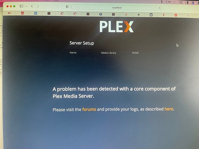

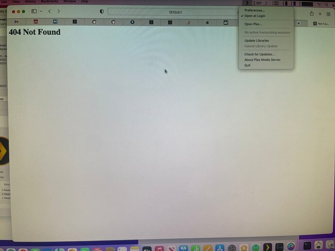

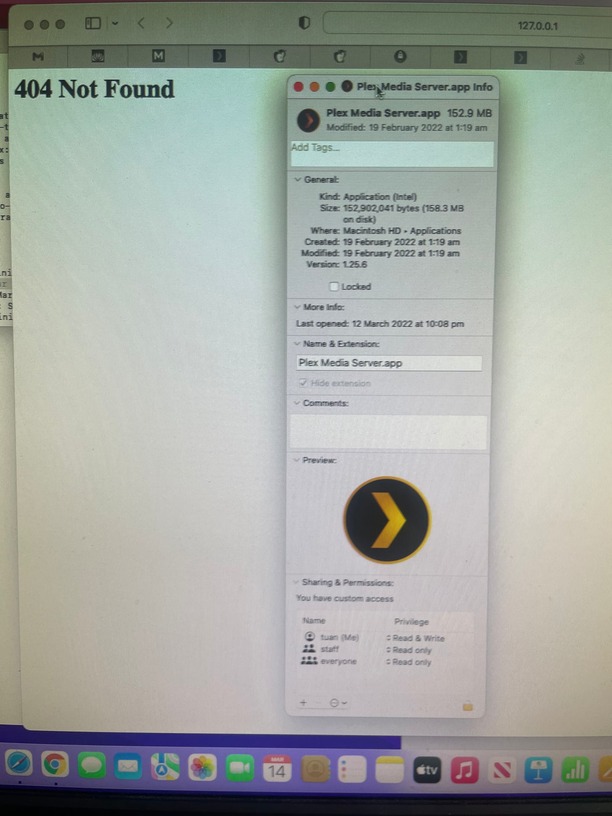

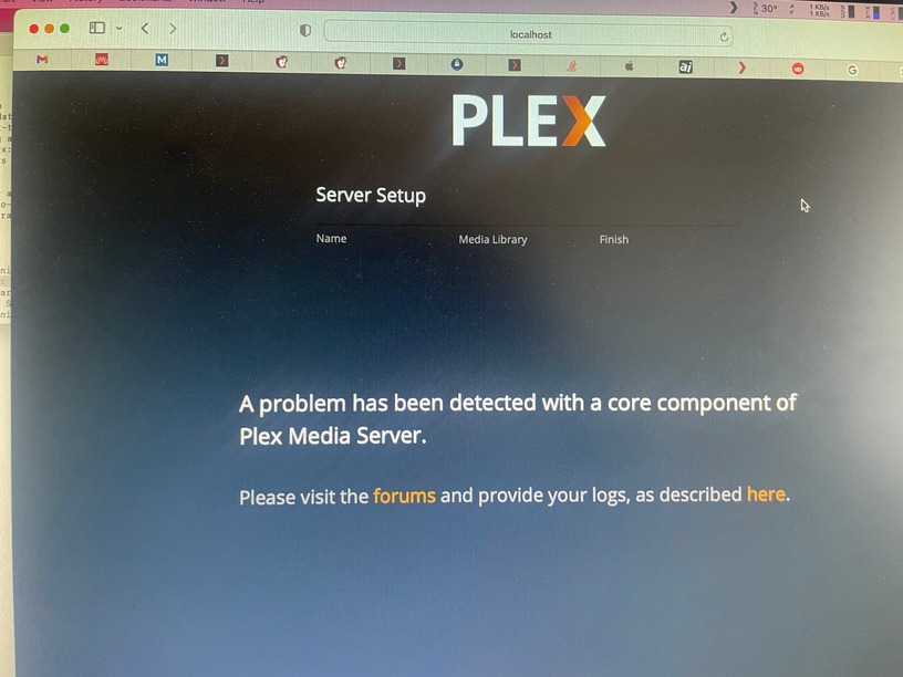

I am unable to install Plex Media Server on an Apple Mac Mini M1. I downloaded Plex Media Server for Mac ver. 1.25.6.5577. At installation, I was prompted to install Rosetta. Once installed, when I click Open Plex from the PMS top menu bar to start the setup wizard, Safari browser returns error message “404 Not Found” while pointing to “127.0.0.1:32400/web/index.html#!/setup/“. If I replace “127.0.0.1” with “localhost” in the browser address bar, I get the error message “A problem has been detected with a core component of PMS”. I can not find traces of Rosetta installed anywhere so I am not sure if it was properly installed.

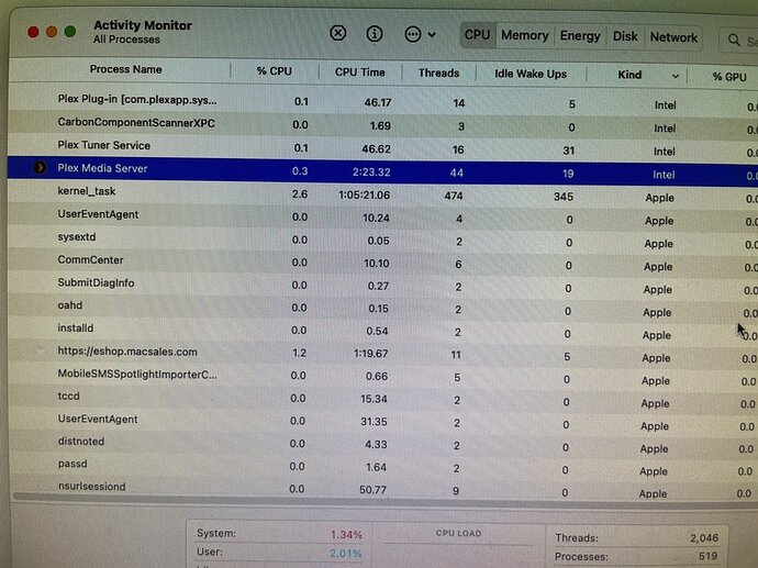

Activity Monitor shows that PMS is running.

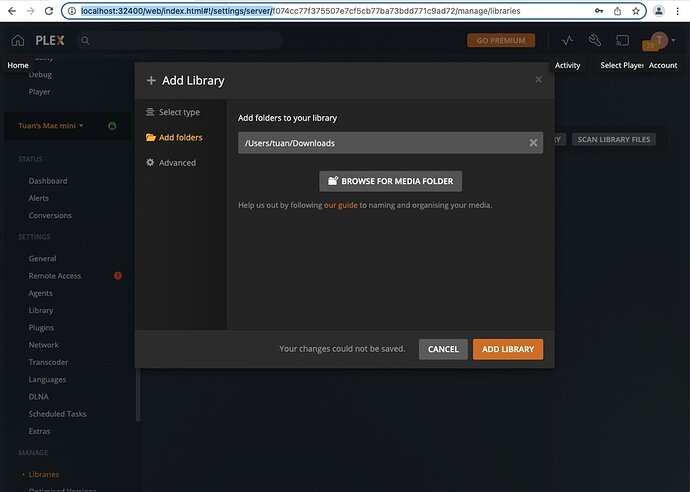

I was able to access the PMS settings and start the setup by replacing 127.0.0.1 with localhost (http://localhost:32400/web/index.html#!/settings/server/).
But now I am not able to add any library or folders. It keeps saying “Your changes could not be saved”. I tried adding local folders on the C: drive or an external USB drive. No luck. I can browse the folders but Plex will not save the changes. Any ideas?

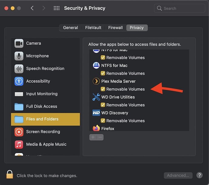

You need to add permissions for plex.
I already added permissions like you said but PMS still will not let me save changes when adding a library or folder.
Security

I followed all your instructions and I still get the same error message when adding folders to a Library: “Your changes could not be saved”
I found the solution: Plex Media Server was not accepting blanks in the computer name.
I changed the computer name from “Mac Mini” to “Mac-Mini” and the installation worked perfectly.
