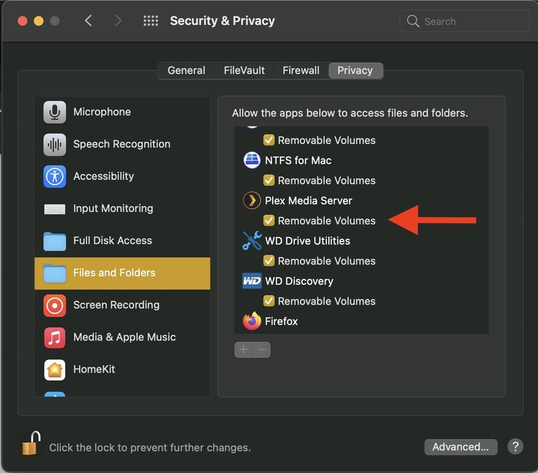

So some months back I was having trouble adding files to my library and updating the library when I would add a movie to my external hard drive that PMS was using. So I attempted to delete the library and re add it. But when in PMS settings to Add Library, the Folder on my External Hard drive were not showing up. I had not made any permission changes and have already checked that they have access in my System preference to include Plex. I also have tested a different external HDD with PMS and it can access everything on it just fine. Additionally, I have typed in the sub folders manually and that hasn’t worked either . I have attached some screen shots. The first one is the external HDD that is being read fine by PMS. The second, blank one, is the external HDD that used to work great with PMS but now can’t be read. And third shot is there side by side drive info.
Any thoughts? It’s driving me crazy and I think I may just replace the drive. Which seems nuts because it works perfectly fine for everything else, and is able to be read by my Mac just fine. I have uninstalled and reinstalled PMS as well.

In new versions of MacOS you need to allow apps to see external drives

As described in OP, Plex is reading a different removable volume just fine. The “Mephistopheles” drive that it’s reading is removable. The privacy settings for Plex are already checked. It’s not reading a different hard drive, that is used to read just fine. PMS suddenly stopped reading the Angra Mainyu drive after year+ of working.
