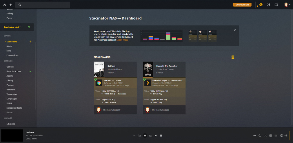

The web player is stuck on the buffering wheel, and even when transcoding finishes it still hasn’t loaded at all, despite other files (with the mp4 extension for the web player) playing almost instantly. The dashboard shows transcoding progress correctly but ticks up the play timer for a bit before switching to buffering when it realises that it is not playing correctly.
The image shows a successful stream using the native windows client (which can handle mkvs), and an unsuccessful one on the same machine using the web app.

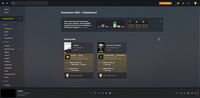

This is not the case as the issue still exists when playing an H264 encoded mkv file through the web GUI as shown in the image below. I also do not believe the transcoder is at fault here as in prior versions of plex, the server has had no issues transcoding these particular files.

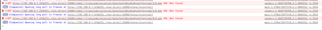

I’m confused now, the OP was about pms not sending transcodes, but that’s a DirectPlay session. And it is reaching the client as shown here, do you see any errors in chromes’s WebTools console log or network Tab?
No, that’s not a direct play session, but a direct stream one, meaning that the transcoder still needs to repackage the mkv as an mp4 to allow it to be played by plex web (playing an mp4 works fine). As for errors, the chrome console has the following errors and warnings
[Connections] Stacinator NAS is unavailable at https://External-IP-Address.plex.direct:29800/media/providers (Status 0)
[Connections] Prevented fallback to insecure connection for Stacinator NAS
[Connections] All connections to Stacinator NAS failed
GET https://Internal-IP-Address.plex.direct:32400/video/:/transcode/universal/dash/1gyn9bdxw6pq00o5zqla4gel/1/0.m4s 404 (Not Found)
POST https://analytics.plex.tv/collect/event net::ERR_BLOCKED_BY_CLIENT
[Player] Buffering detected, last position change was 521ms ago
It also seems to be opening a large amount of long polls (approximately 2000) before detecting buffering

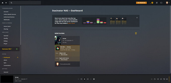

Ah you’re correct, I saw H264 and AAC and didn’t expect a DS so my brain tricked me :slight_smile:
It should direct play though, and now that I look more carefully I also noticed the “10Gbps” which means we probably don’t have the correct bitrate of that file.

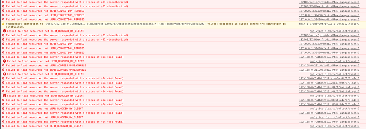

As is the case for ThomasRules2000, using the webui, I get a lot of 401s and rejections. Also, gobs of long polling:
A lot of those are on 127.0.0.1, might not be it but are you sure the jail is created with VNET enabled, its at least suspicious that we can’t talk to 127.0.0.1, this can happen in a jail without vnet though cause then it wouldn’t have a loopback.
