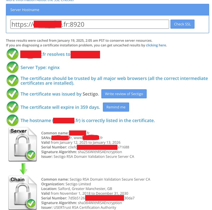

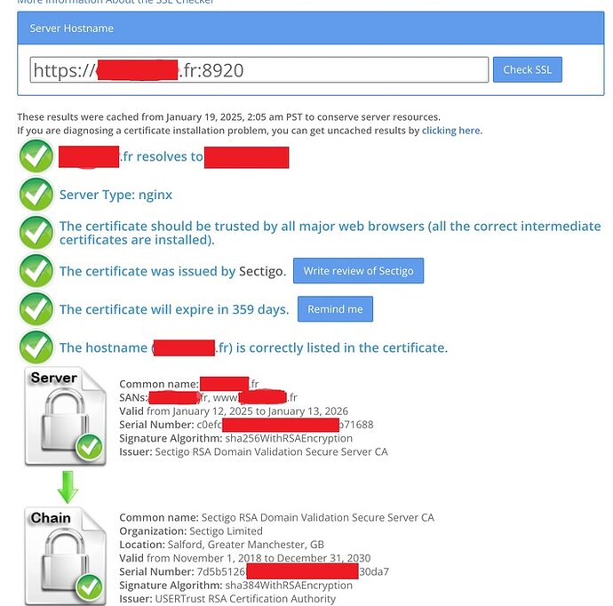

Hello
My pfx generated cert file is also used with Emby (I know, I crossed some lines), and I checked my SSL access. Here is the result
As you can see, the cert, chain files are ok and active. So I really don’t understand why Sectigo Cert files don’t work with Plex

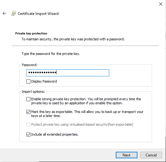

2. Create a new valid PFX file:
a. Import the existing PFX into the Windows Certificate Store
b. Using certmgr.msc (C:\Windows\System32\certmgr.msc), import the existing PFX file.
c. During the import, ensure the following options are selected:
  • Mark this key as exportable
  • Include all extended properties
