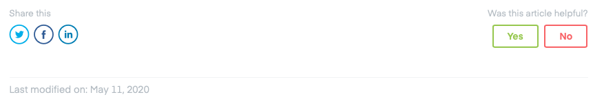

At the bottom of the articles you linked is a question: “Was this article helpful?”
If you click “No” you can leave feedback describing what you believe would improve its helpfulness.
Thanks @pshanew.
I didn’t feel that was sufficient for an issue that’s been documented in about 3 years of forum posts that I was reading through.
Both the extended guide, and the main thread describing the issue I linked in my first post - are from 2017/2016. With the issue thread having people report this almost yearly, including one user for whom this blocked a system upgrade (due to an unknown file lock on a folder, the same file lock I noticed too).
I thought it was worth raising again to see if it could be actually addressed in a more official form - either with a correction / better workflow by the dev team or an actual integration into the Plex documentation.
I see that may have been too ambitious. I’ll just click the link. Thanks.
