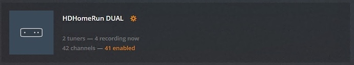

Thanks! That clears it up. It’s also supported by seeing that after doing back to back recordings, I have 2 tuners but showing 4 recording now…

This is likely related to the issue reported in this thread.
https://forums.plex.tv/discussion/274585/issue-with-tuners-and-recordings/p1
Currently the only “fix” seems to be rolling back to an earlier version of PMS. Several are mentioned as working in the thread. I’m on 1.5.6 which doesn’t have the issue. Some have reported later versions working, but I havn’t tried them. I know the most recent release has the issue still.
One issue I discovered this evening with rolling back is I see some DB error messages in my Plex Media Server log:
Jun 30, 2017 20:01:48.977 [8620] INFO - SQLITE3:B0088E6A, 17, statement aborts at 57: [select * from metadata_items limit 1] database schema has changed
Everything appears to be working but apparently the database changed between version 1.7.5 and 1.6.1. Uninstalled 1.7.5 and installed 1.6.1 the other night.
